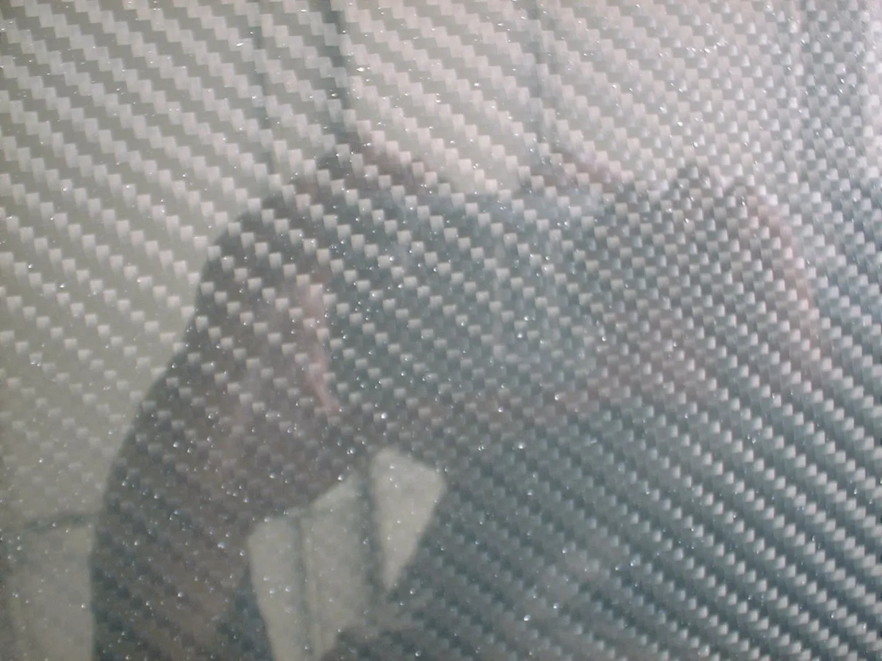

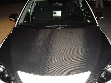

I got the cheaper one... here are the pics, there is absolutely nothing wrong with it...

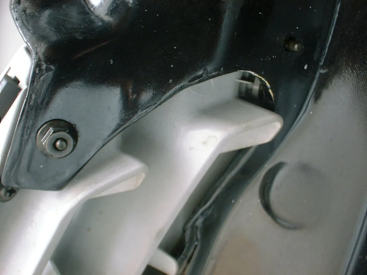

the hood latch is fine, but the grille is another issue. I was gonna explain more when i posted the pics, but its a pain... I could only put 3 bolts on it because of the hood shape. However it caused no problems with clearance or being too loose. Hope that answers your question.

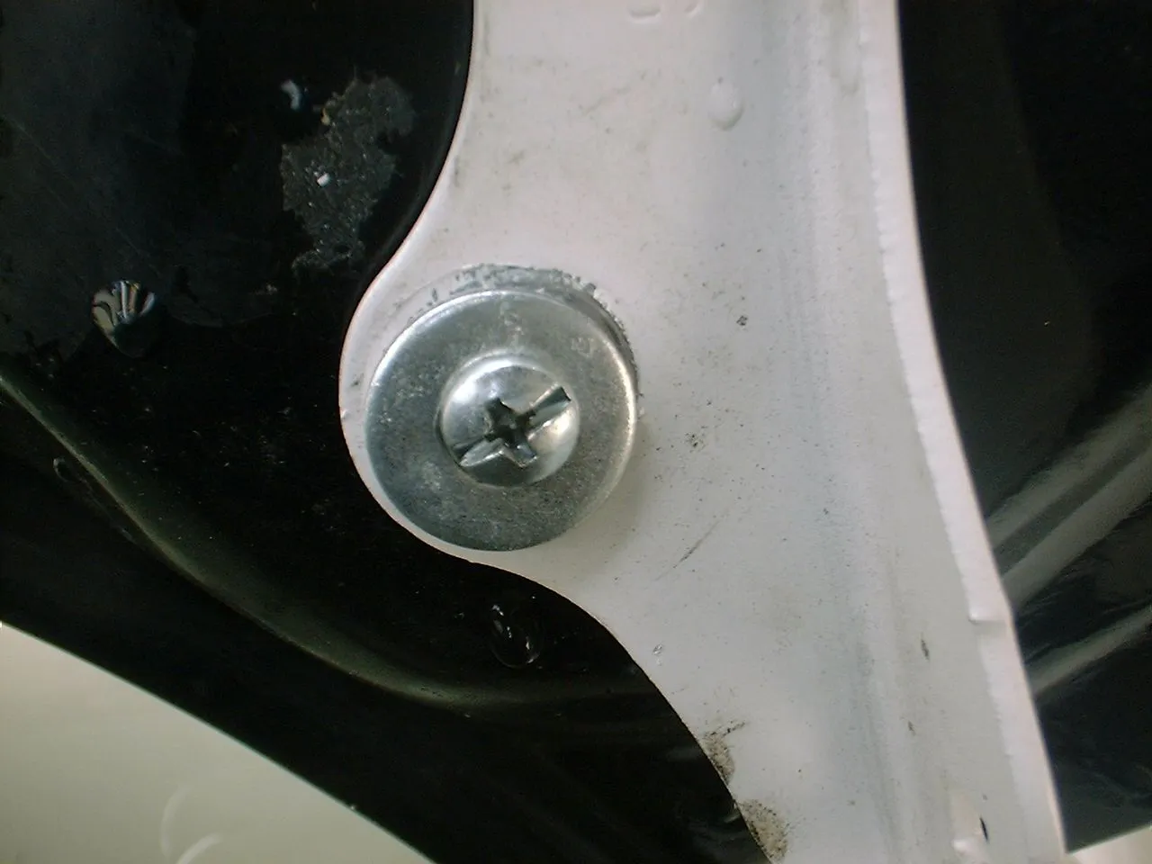

Sorry guys, diddn't get a chance to take pictures last night(late night at work), I'll get on it tonight after work. I forgot to tell you about one MAJOR detail about the hood! I couldn't use the stock bolts on it(you can if you have a dremel tool and make the whole bigger, I don't have on...), but you can use other things(I used screw,washer, and anchor) to hold it in place(it's alot tighter). Anyways I'll take pictures and try to explain more tonight.

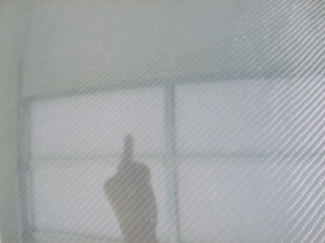

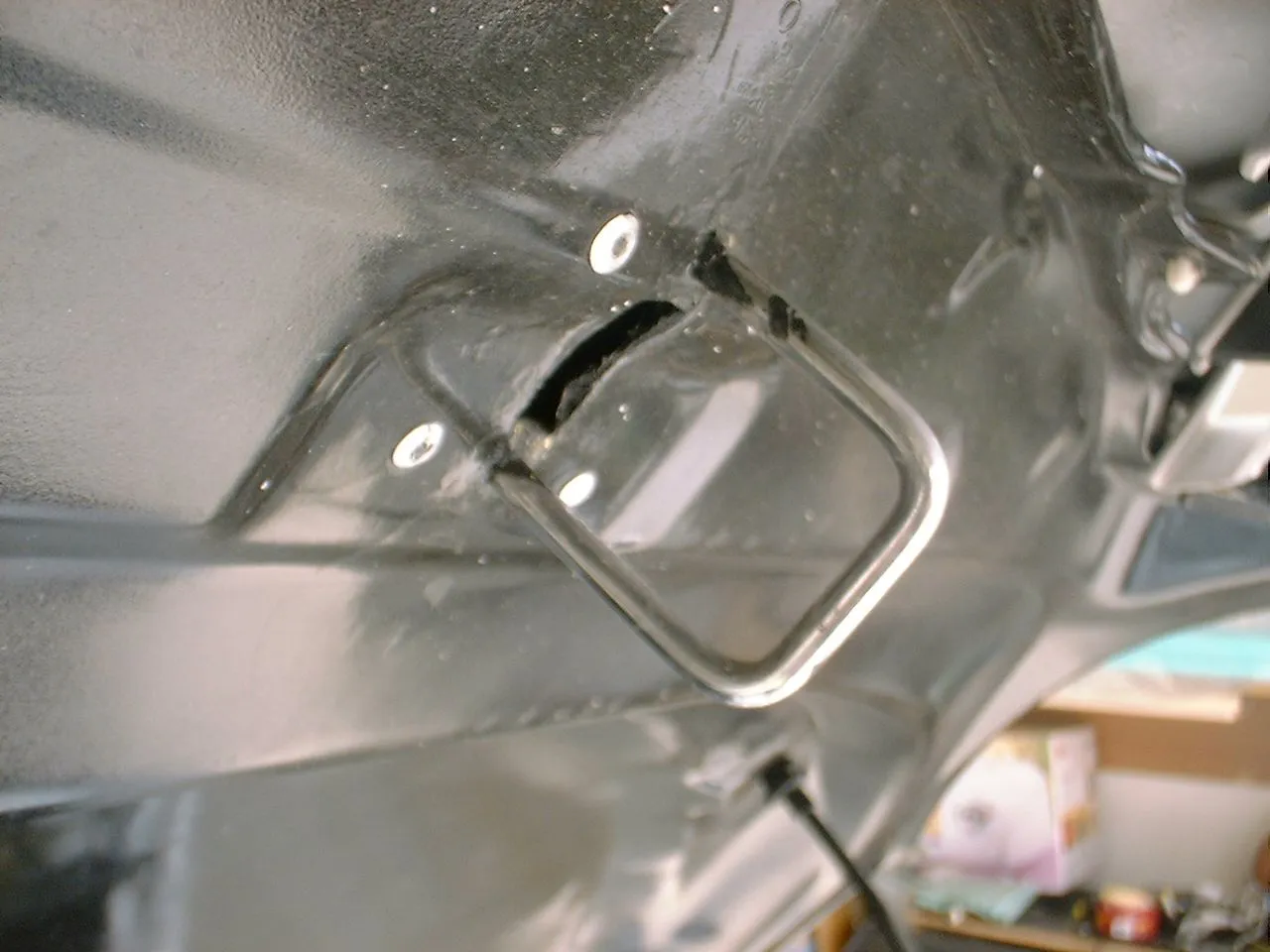

Alright, here we go!!! First I'll start off with the hood bracket issue. I couldn't use the stock bolt(no dremmel tool), so I used anchor and screws instead. Also, I had to put a washer on my driver side bottom one to get a better fitment of the hood. Next 2 pics shows the quality of the CF(bad azz shiny!). Moving on~, this pic show the one bolt that I could not do on the grill because the dang thread can't come through.... And the last one for this post is the hood latch. I don't remember who asked, but it is fine and is no problem(???).

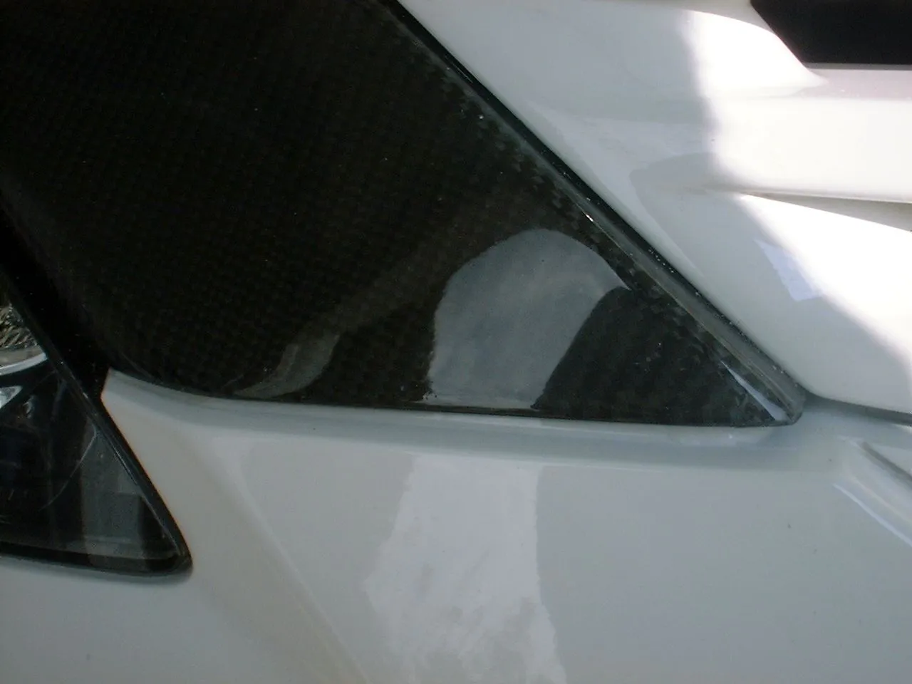

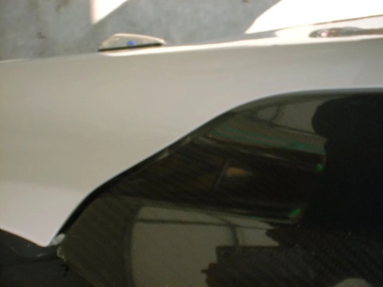

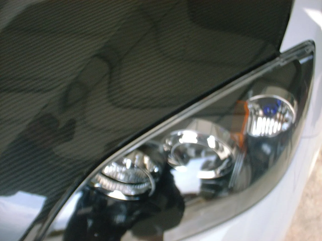

Ok, to continue, these are pics of the fitment of the hood. I tried to get some pics of the important areas where the fitment is supurb! And to get on to our last topic of issue, it is a pic of the windshiel washer nozzel. It is on there, but not functional. Like I said before, I needed to buy the aftermarket windshield washer nozzel(not interested).
