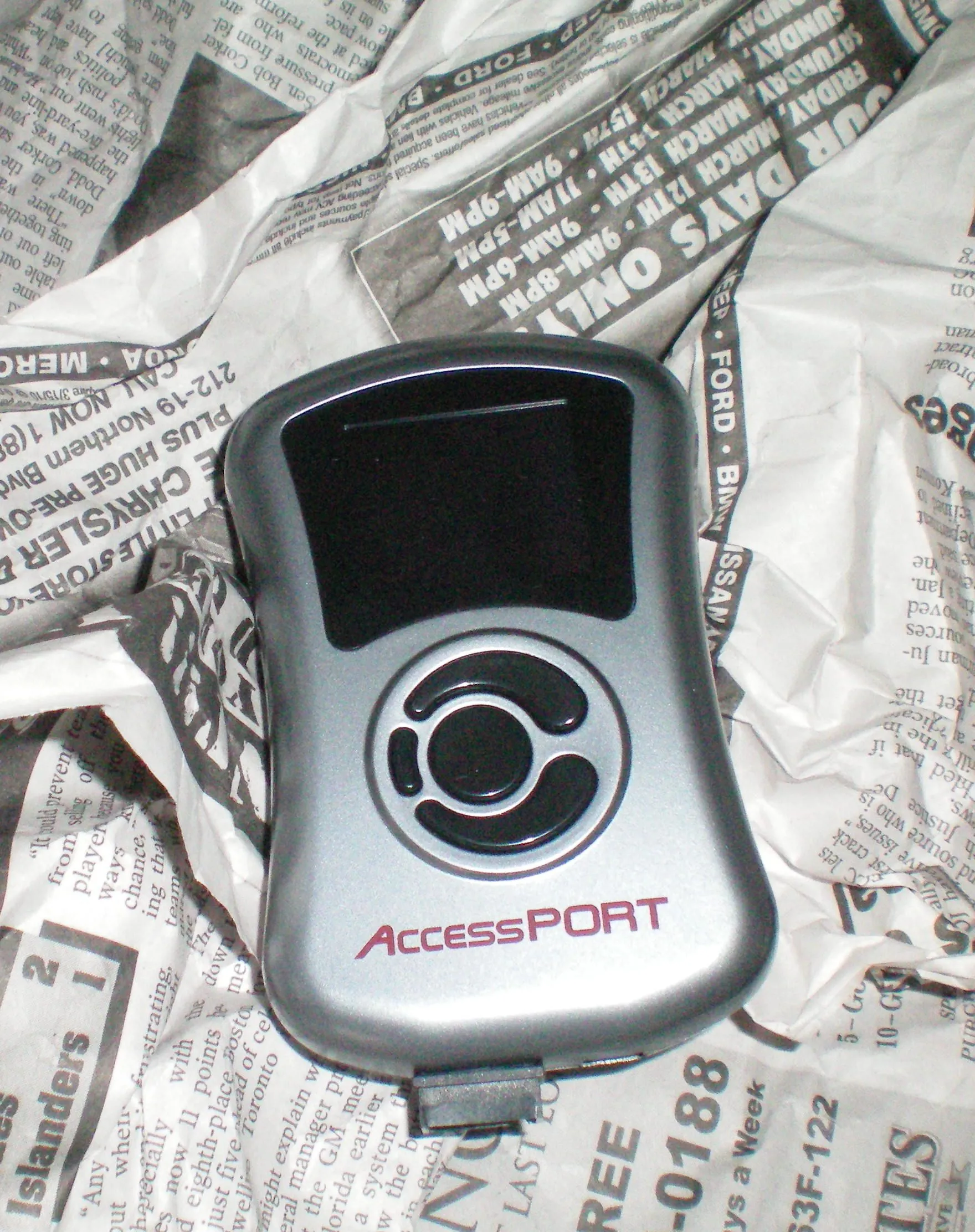

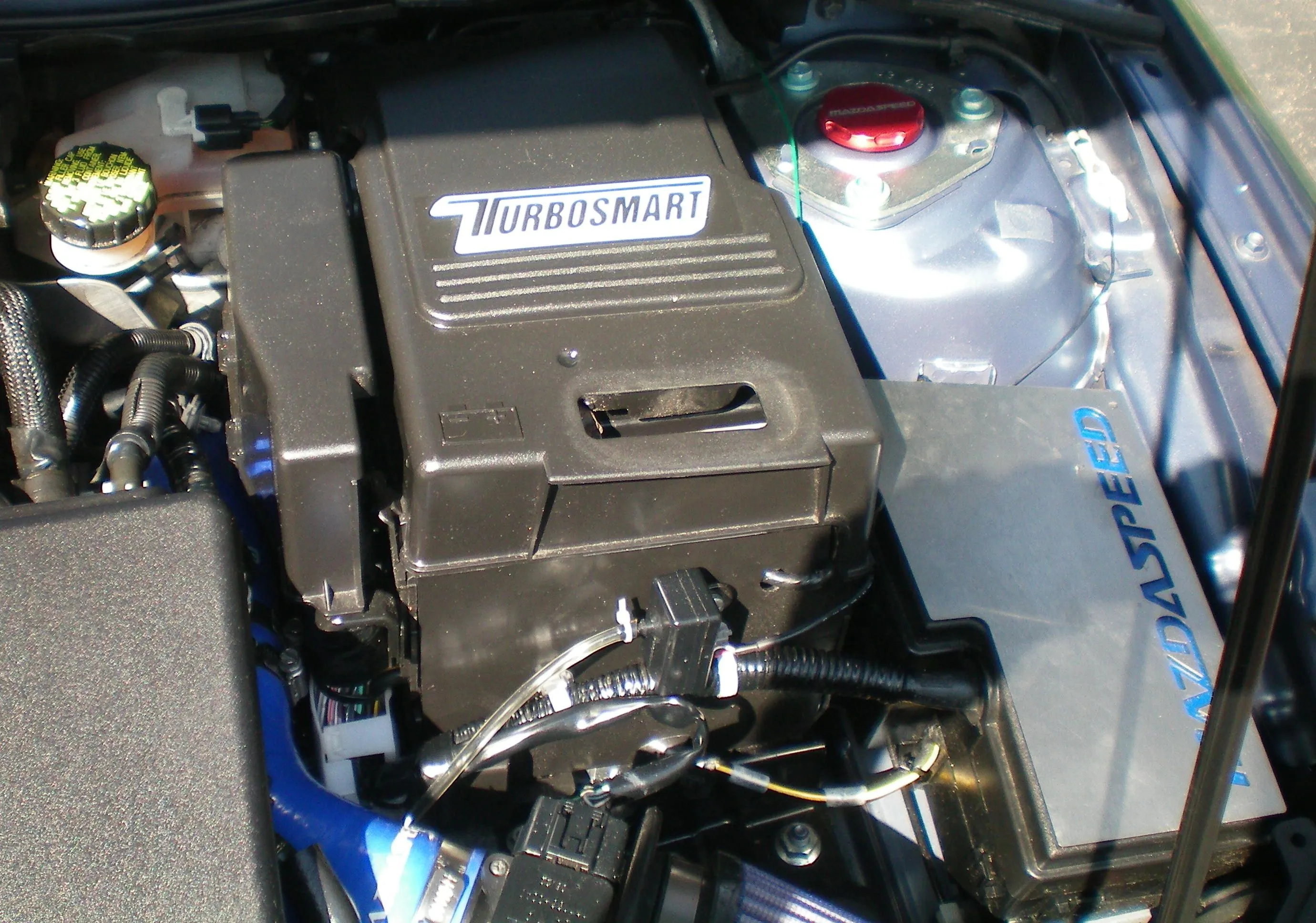

Ok, well its thursday and I just received my ECU and AP from COBB. I mailed it to them monday and I got it back from them by 10am today. Thats less than a 4 day turn around. Long story short, the AP had my car down as a federal when in fact my car's ECU was registered as a california model even though I bought it in Jersey. That might be why I had the problem. Regardless, I have installed the ECU and AP with an ATR modified stage 2 map and it's running great. Feels so good to have it over with. Only cost to me was the overnight shipping which came to around 30 bucks. Thanks to everyone at COBB for great customer service. Now if you'd only bring back your FMIC!!
PIC 1 - Box from Cobb

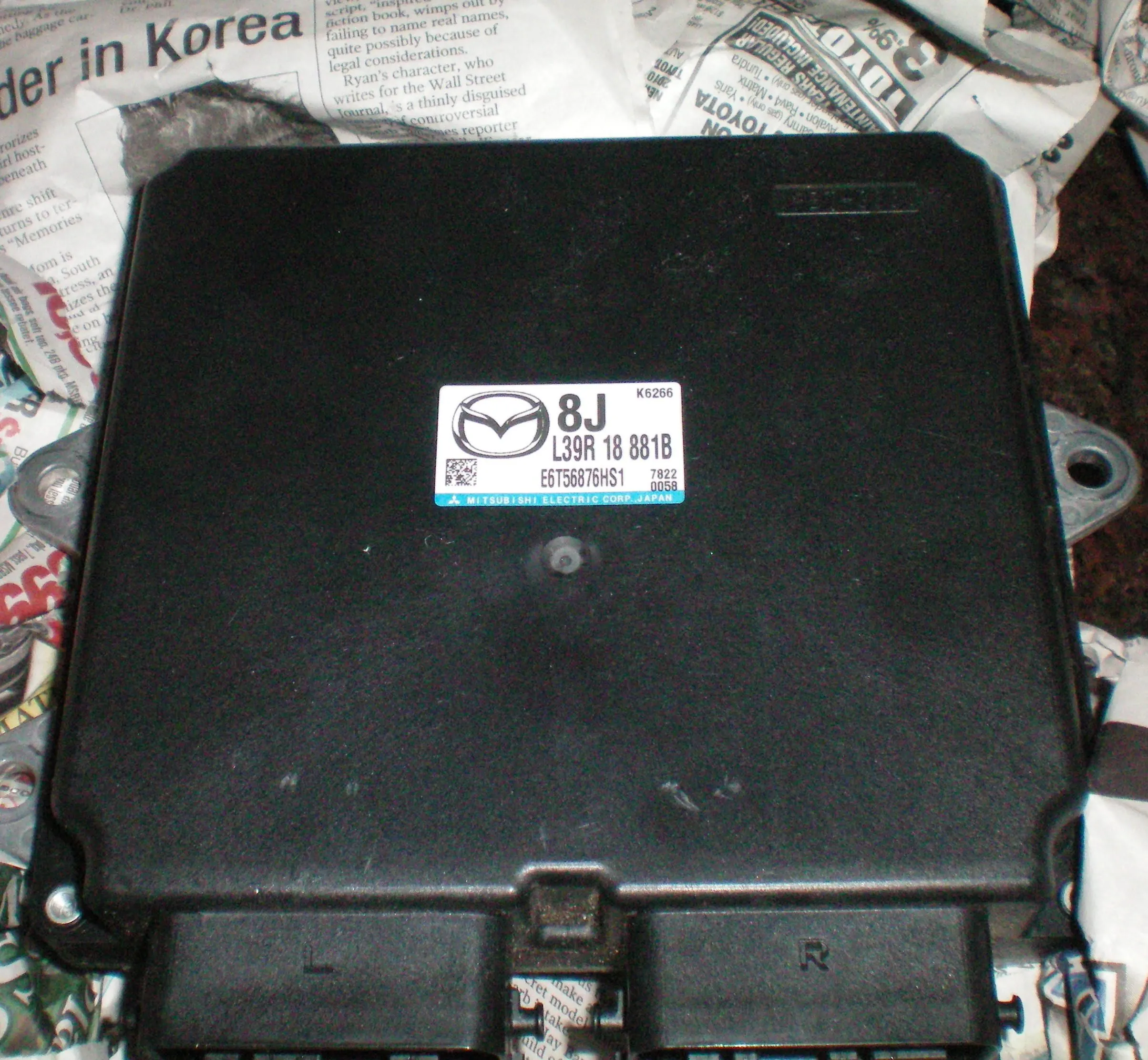

PIC 2 - ECU
PIC 3 - AP

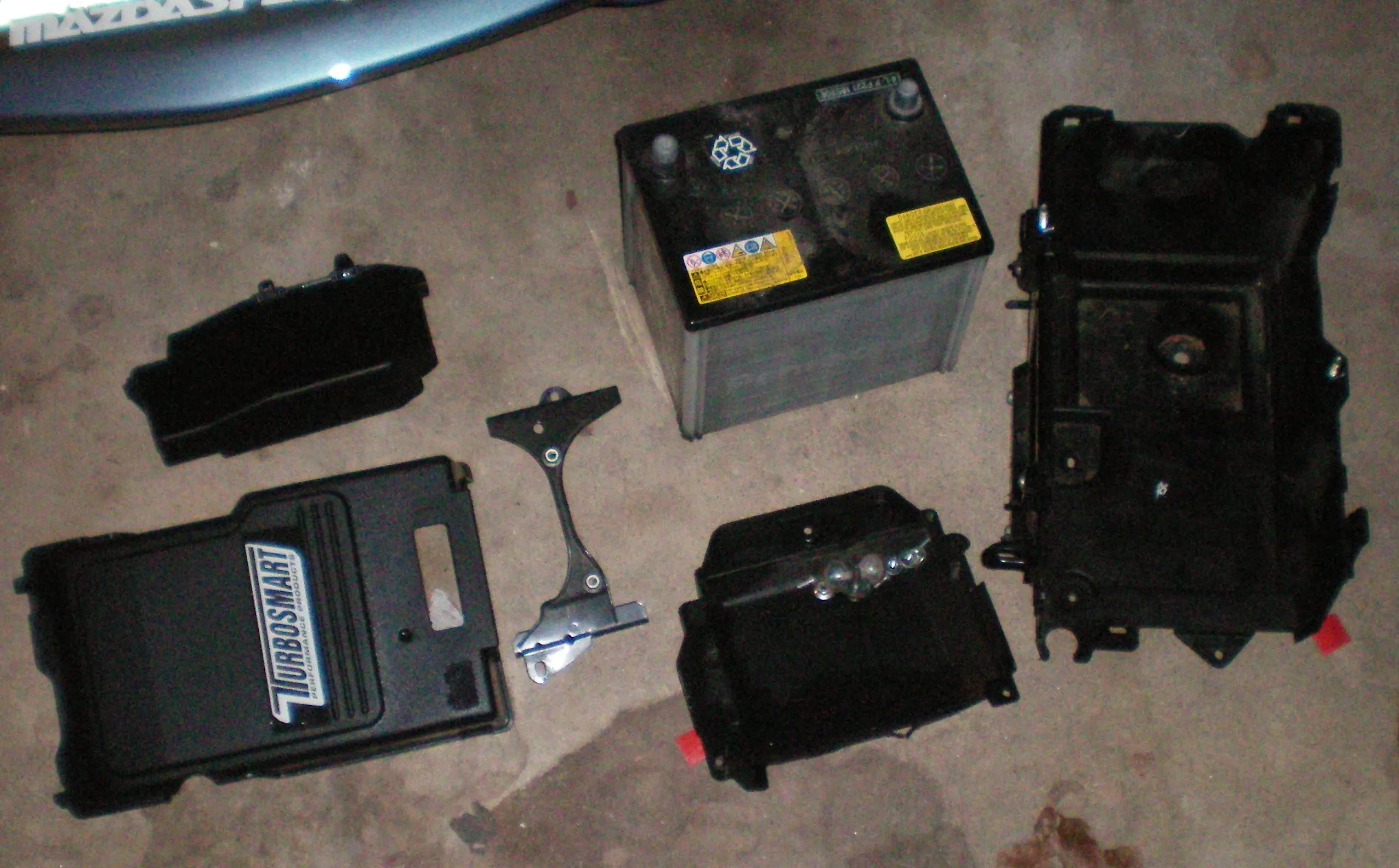

PIC 4 - My gutted engine bay
