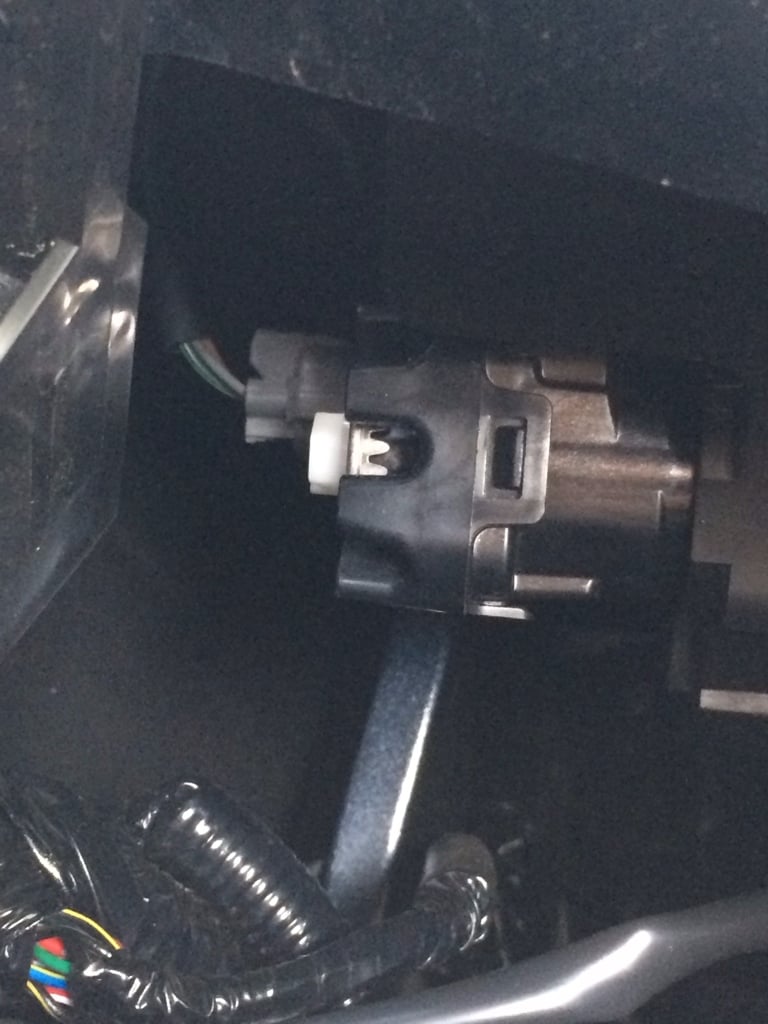

I'm guessing you don't have the adaptive bi-xenons, and I do so I'm not sure if your headlight adjuster looks like this but I think it does. A large Philip head screwdriver or 10mm wrench will adjust it, and turning clockwise adjusts it up, I believe.
Regular headlights are a bit different, but same idea. 10mm silver bolt head on the rear of the housing turns clockwise to raise the beam. I marked the bolt so I could tell how many turns I gave it and raised each by one and a half rotations, which did the trick.
