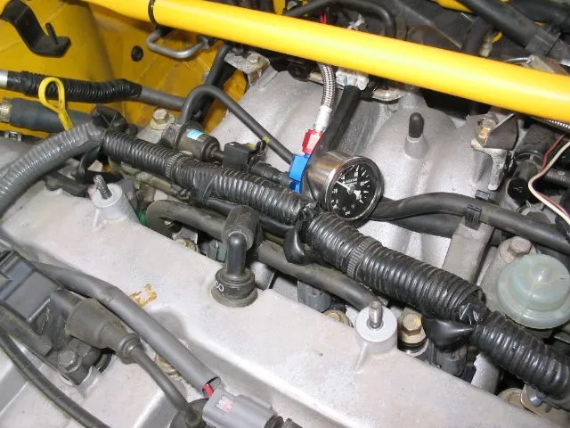

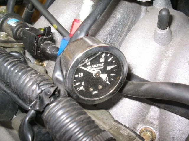

matt, be safe and get a fp gauge and a wideband, then you will KNOW what's going on with the car. the stock pump is fine for how much boost you are running.
get one of these :)
BTW - even with a fuel pressure regulator running pig rich, without an inline fuel pump you will run lean under boost. even with the voltage clamp AND a wideband. StuttersC had this problem - could not hit above 60psi of fuel pressure. you need between 88psi and 90psi of fuel pressure for 8 psi of boost..
