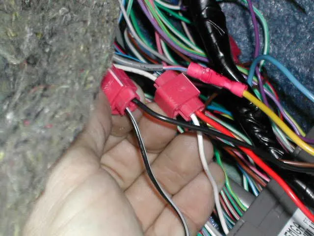

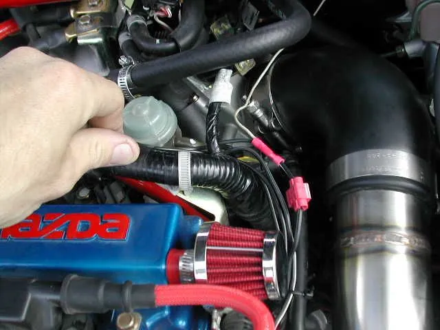

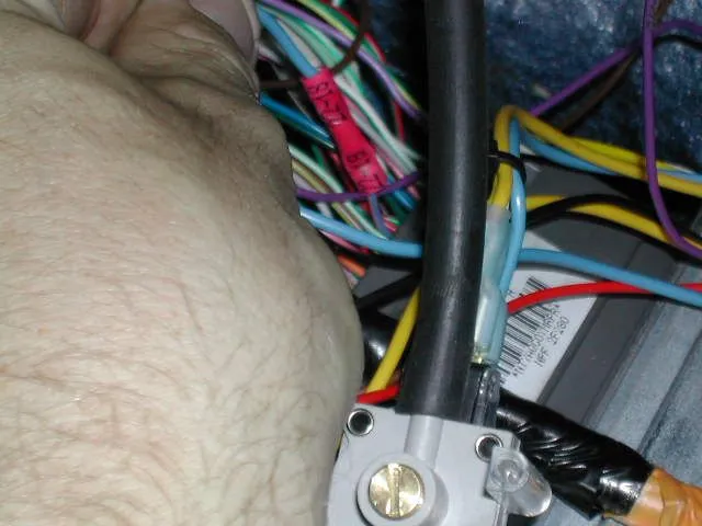

some pics mostly of the voltage clamp

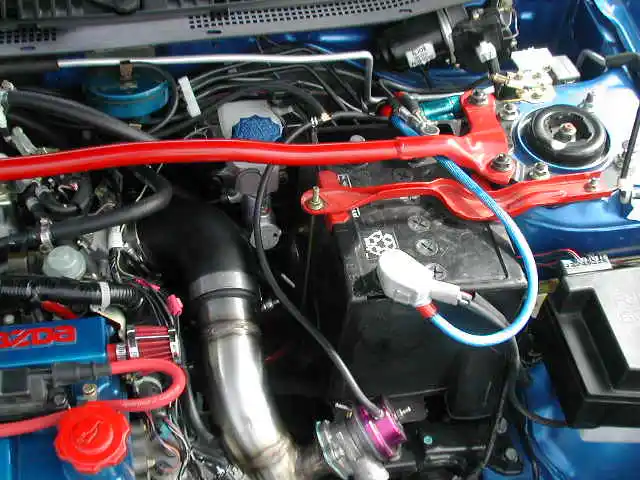

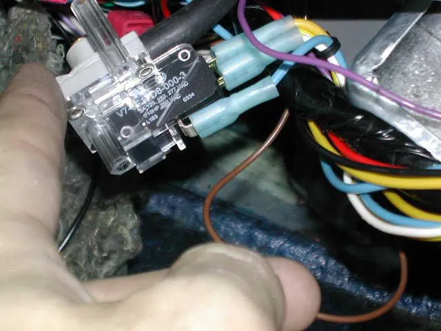

two more pics.

how old is that fmu? it looks like its been around the block a few times...
-B
it was on mp3skaternc's car...he said it worked fine on his...how can itell if its not working
also, with those self taps, you have to be careful that they dont accidentally cut the whole wire in half. I have had that happen a few times. I would check your wiring, open all those quick taps and make sure you didnt cut a wire all the way in half accidentally. If that were to happen then obviously tour voltage clamp would not work.

if one of those things DID cut the wire in half it would come out of the clamp, wouldnt it? i pulled on them all and they were all snug.
matt. sometimes u can cut the wire in half.. and the lil piece of s*** plastic wrap can still hold. -=\
not necessarily, it could still be lodged in there. I would say open them up and inspect for your self. The sheathing may be whats holding the wire together. Other than that and the fmu being hooked up wring or being broken, i dont know what else could be the problem.
-B
take off those pieces of crap and either get butt-splices or solder... PLEASE!!!!!
dude, those things are the devil... and if I didn't have s*** to do I would personally come down there and solder every last one of those wires for you.
butt splicers are good.. take a lil more time but they will last longer.. also if your proficient with a sodering iron.. that is the best.. just make sure to use th heat shrink wrap over it. -=)
