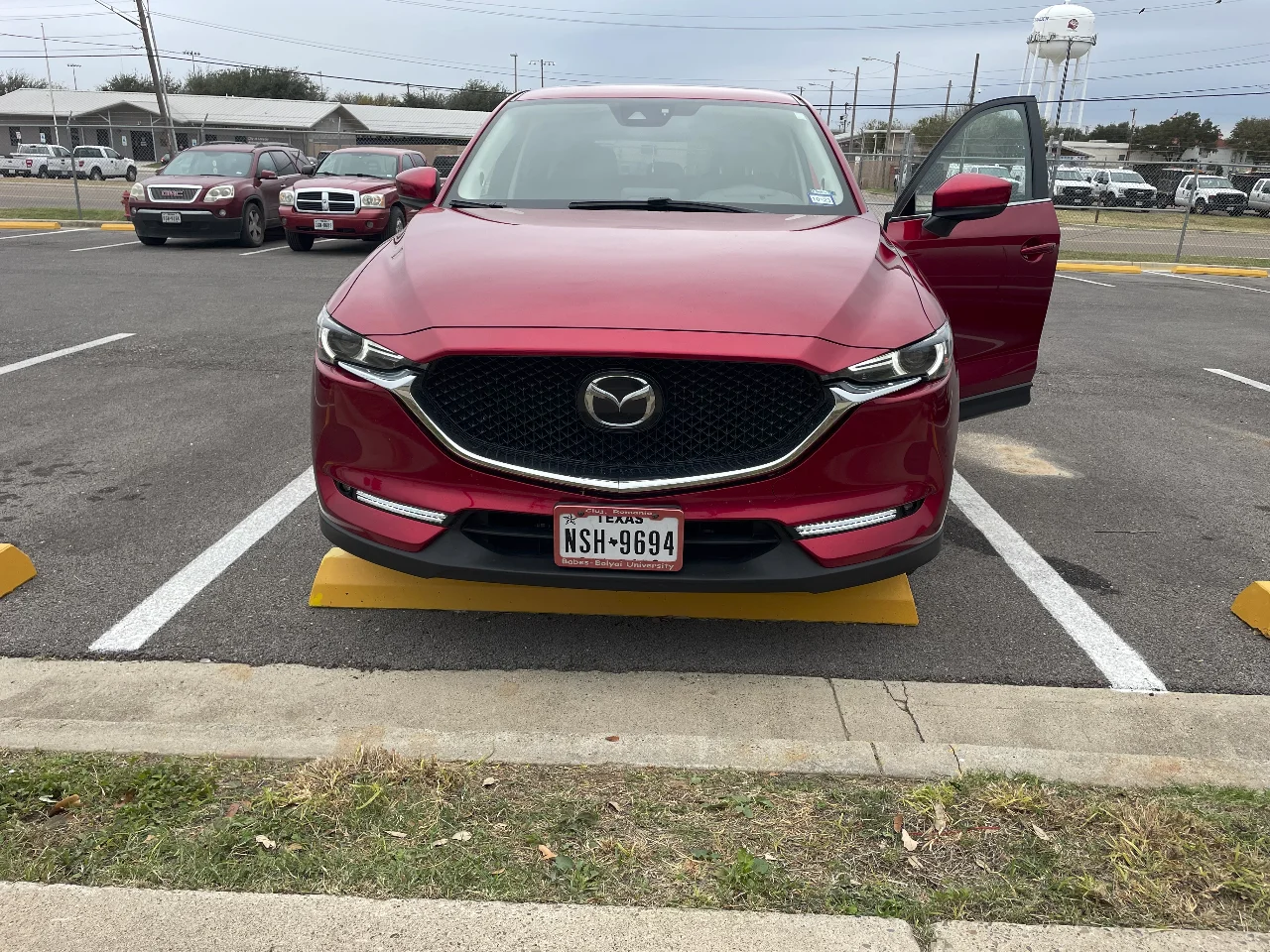

I chose to remove the DRL relay because I wanted to have the accent LED lights only for DRL. At night I simply turn the stalk from parking lights position to low beam. See the picture.
Thanks for clarification.I left with impression that removing the relay will disable at all the rings, not having them at all at any position of stalk.I will try and will come back.
