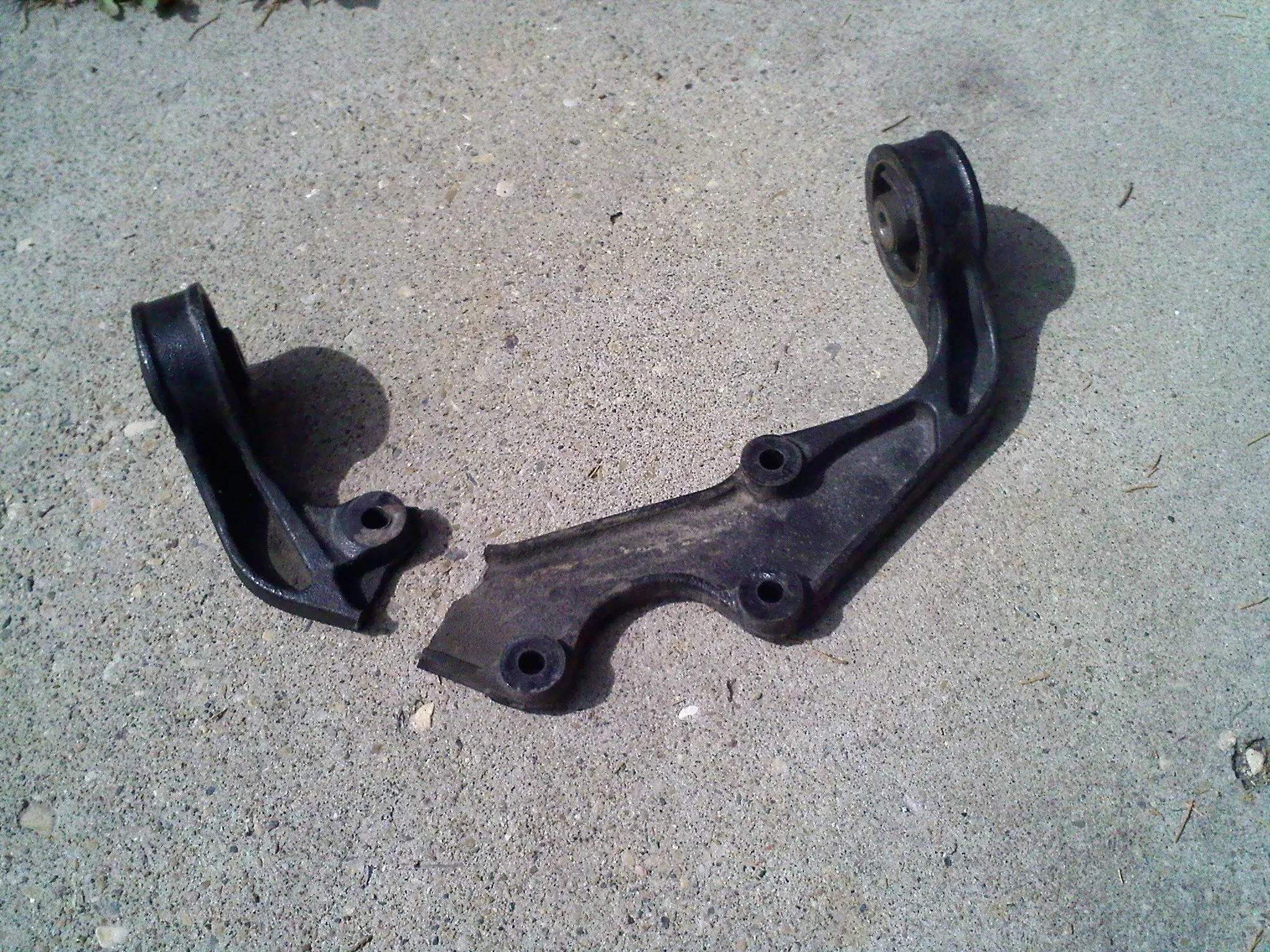

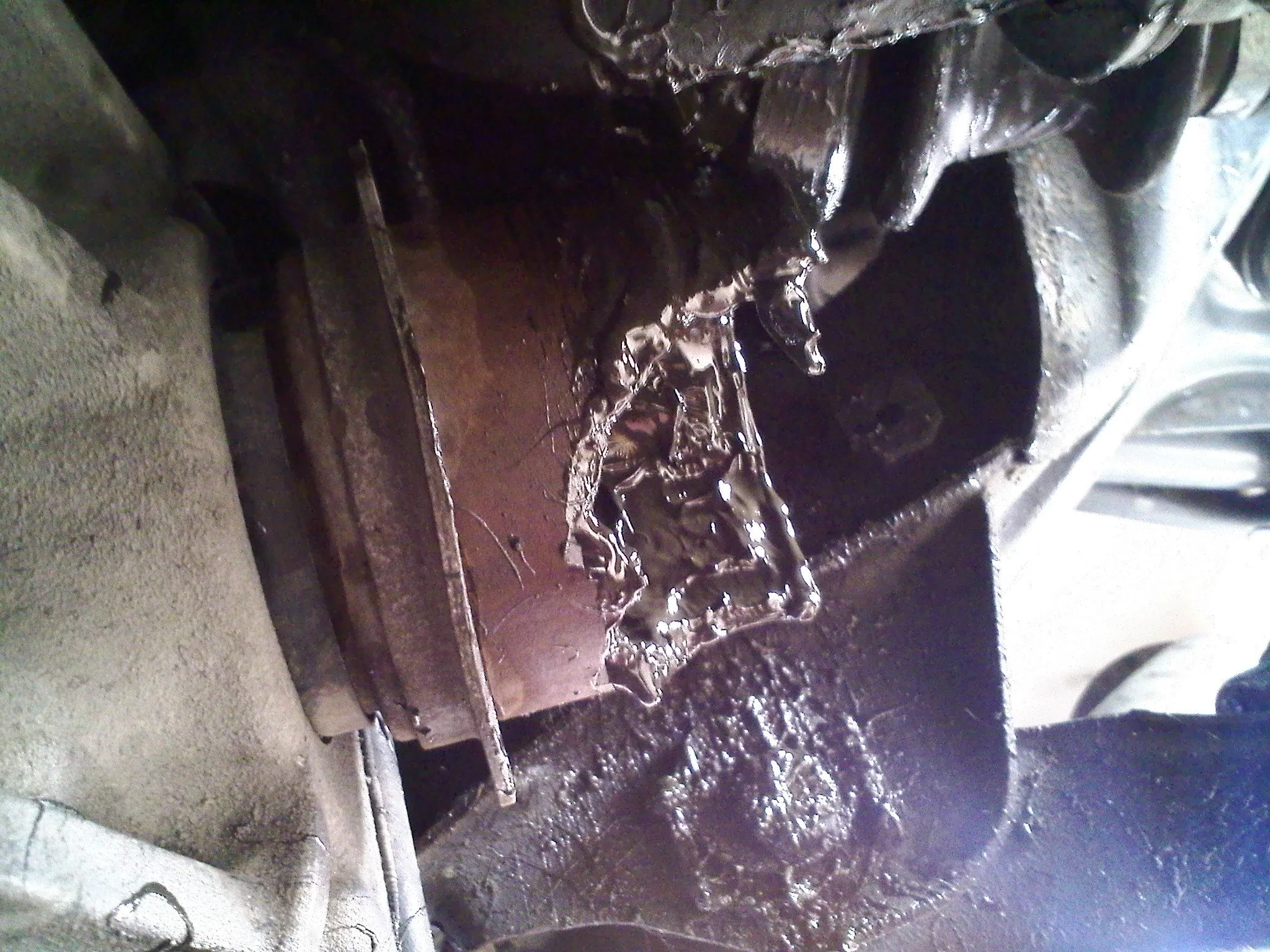

I've also been doing some research on this. Because of the way the rear diff is mounted and the LSD. You don't always notice it but you get some wheel hop when turning, and under hard acceleration. Mazdas aren't known for having the best CV joint, but are better than most stock CVs. If is starting to go you'll notice some abnormal play in the joint instead of in and out you'll see the half shaft kinda wobble if that makes sense. If you catch it early you will avoind other problems like break the diff mount/s.
If you do have a bad axle all it really takes is for it to blow like this is for to slip and then catch traction then BOOM. If you notice in the first pic look where the halfshaft went. Look for the boot at the top right of the pic. Don't take it to Mazda for them to diagnose this they have missed this TWICE before I'd had a problem.
