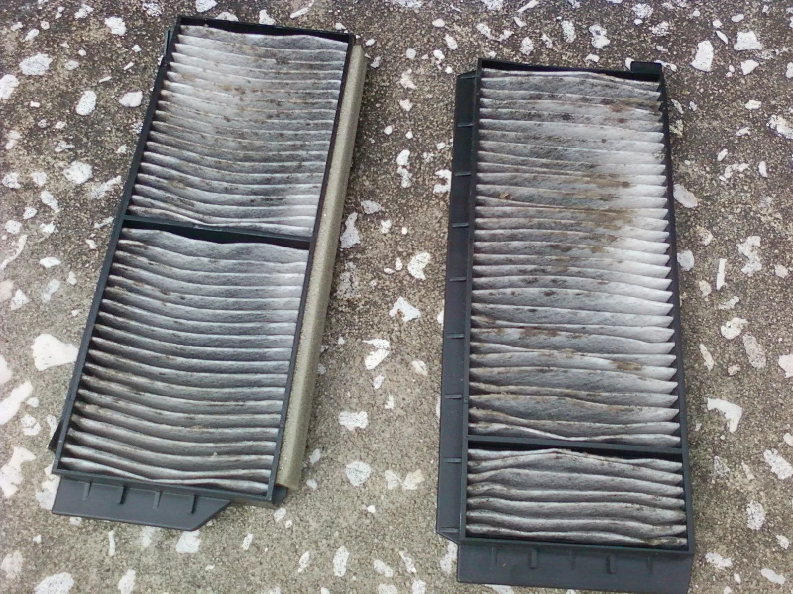

Yeah...20K is the interval to which they need to be changed. I used an extremely helpful video on youtube to help me change them out. Had my laptop out there and did all in about 30 minutes. A lot easier than I thought it would be.

after you get to em, remember that little phrase " the first one lays in high, and toward the firewall"
use your right hand for that. palm toward the firewall, thumb against the outer bottom corner of the filter to keep the inside edge kicked up into its home THEN with your left hand, palm upslide the bottom one into its channel groove on the underside of the top filter an it slides right in easy
dont do this part as soon as you get the flippin cover off, clear all the tools out of the footwell, take a short walk, get your mind calm. then they will slide right in.
oh, and you only need to pull the harness plugs on the top of the pcb
