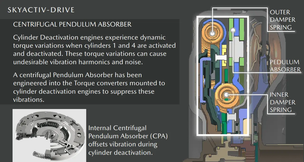

The reason why the ATF could get contaminated by iron powder is because the CD transmission uses a more traditional single clutch with more aggressive material to survive early lockup which would experience significant issues and early wear. It has a pendulum damper which is built into the torque converter and because of its size there is no room for the multi-plate lockup clutch set that the non-CD transmission has.
This has been an issue for a little bit. The CD cars do not have the same lockup wet clutch set as the regular skyactivs do. They use a more traditional single clutch with a more aggressive material to survive early lockup. Many oems that have tried early lockup with this style of clutch experience significant issues and early wear. GM with the 6L80/90 family are the most notorious for this. The clutch set that turns on going into 4th is a more aggressive friction material that is already high metal content. The iron contaminates that set and is similar to what happens with a brake pad that becomes contaminated and makes a squealing sound.
Yep, the pendulum damper is built into the torque converter and because of its size there is no room for the multi plate lockup clutch set that the non CD cars have.View attachment 324785

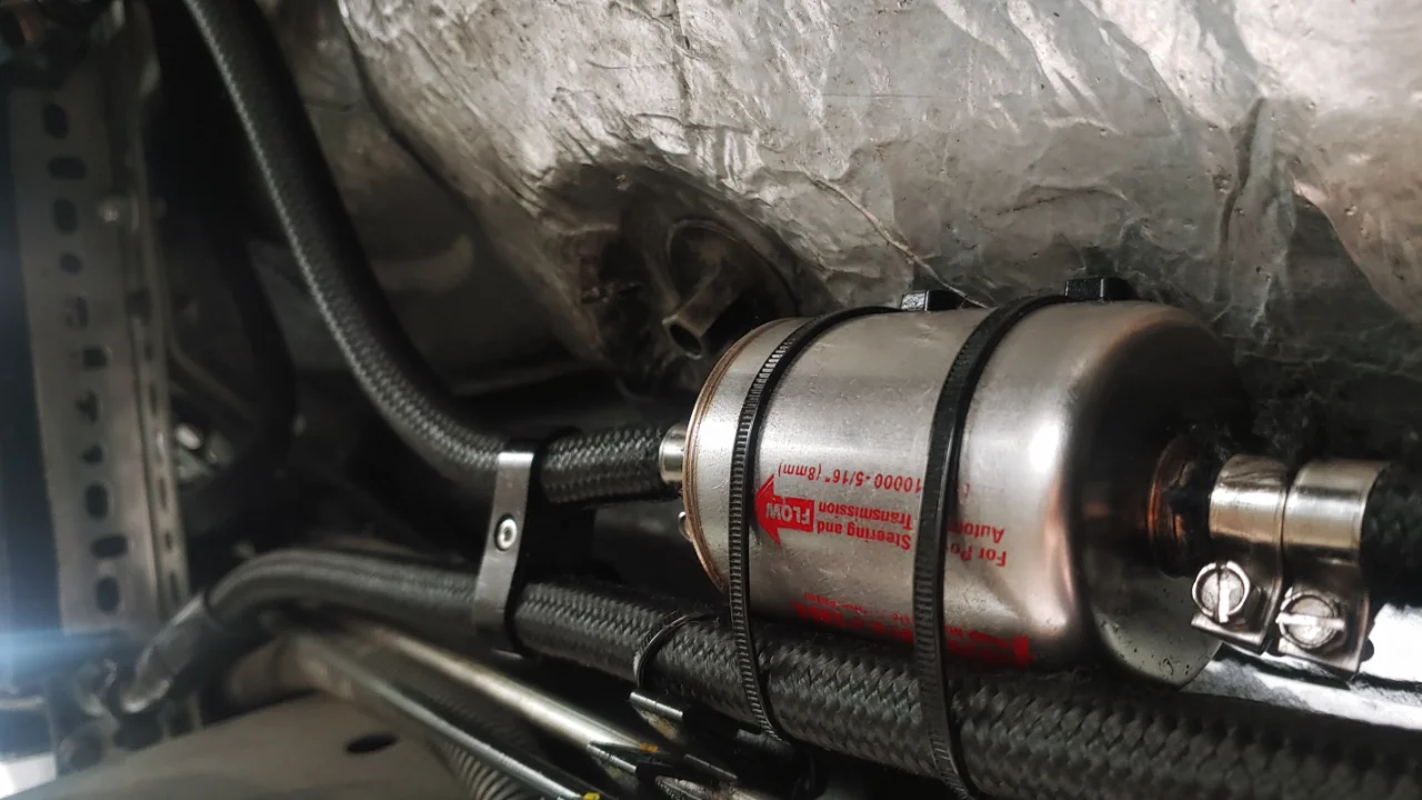

If I owned a CD, I'd install an external trans filter with magnet. The magnet should catch any iron that g ers past 2 filters.
I installed an external trans filter on my Dodge, Diesel. Tran lasted 230k mi and I killed it trying to change out a band. This trans should go 350 to 400k mi. I'll change the filter every 30k mi when changing ATF.
The idea of installing a second external ATF filter on our SkyActiv-Drive automatic transmission isn’t possible as there’s no external ATF lines available to hook up. Yes we can find a third party ATF cooler adapter to get ATF circulating access, but that seems to be only a temporary solution not sure you can keep the adapter permanently on the ATF cooler location.
Of course I was wondering why the big factory ATF filter can’t do the job filtering out the most of iron powder. And the TC replacement procedure outlined in the TSB described nothing about replacing the dirty ATF filter but the ATF change steps (3X drain&fills officially verified).
