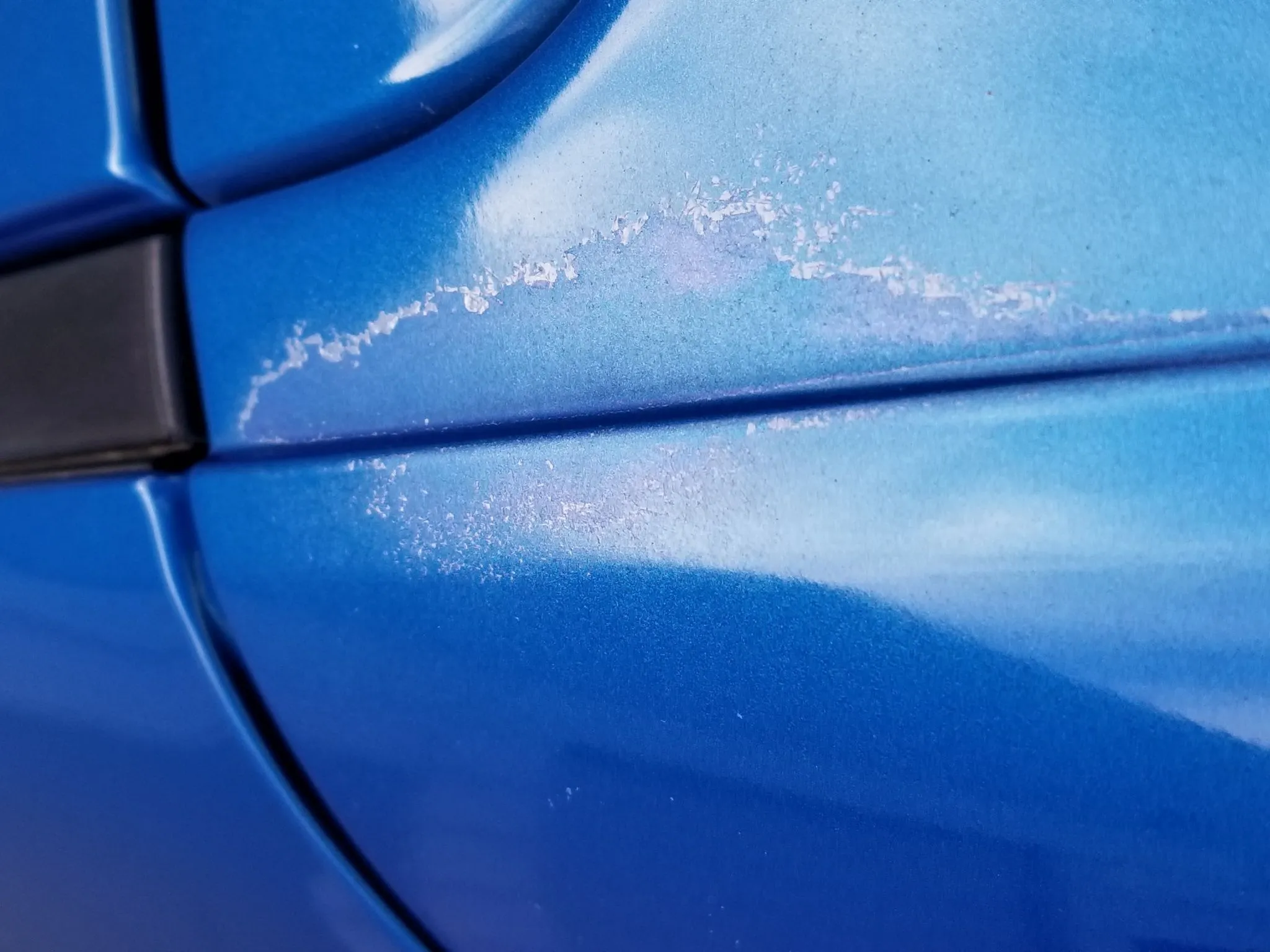

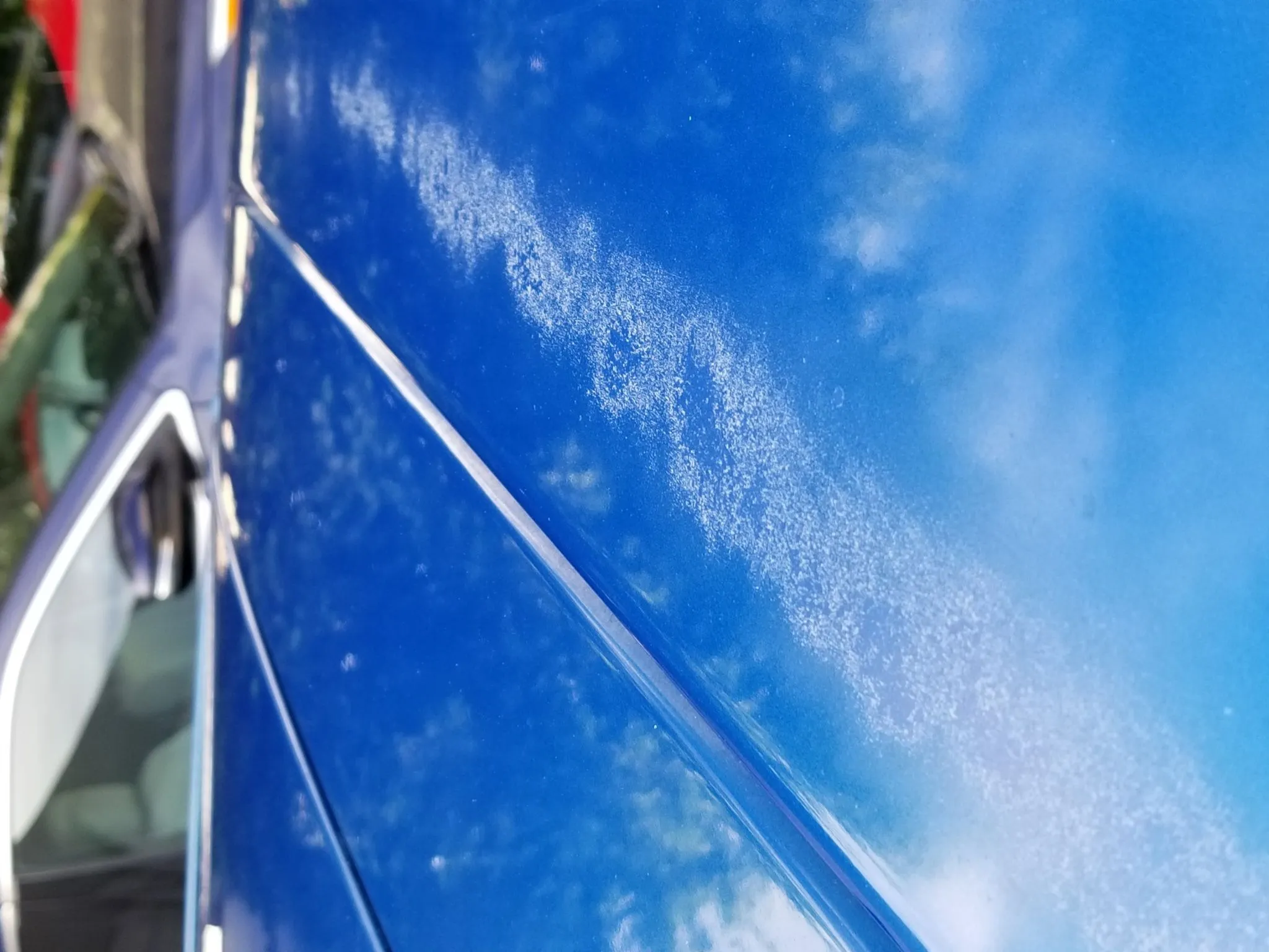

Today, after my car was washed, I have noticed this clear coat burn on my hatch spoiler.

That's either a bad batch of paint from the date of mfg, neglect on your part for never waxing or sealing the paint, some serious sun fade or somehow a chemical reaction up there occurred to make it peel and flake. I'd wet sand it several times and then buff and polish it to at least make it look better.
How often did you wash and polish the car?
And what kind of soap? This looks like what Ive seen from people who use dish soap to wash their car, not knowing that it strips all protection.

Your paint looks either sun related or clay bar related. Did you clay bar your car? I once clay barred an old car with not enough lubricant and it caused similar damage.
But is it just in that line? That suggest something was hitting that specific area.
Clearly an indicator that your car has spent too much time in the SoCal sun and probably hasn't been garaged. Right? My 2013 Sky Blue Mica (also with 45k miles) has paint (including the plastic parts) that is as pristine as the day it rolled off the showroom floor.

If the car was properly washed and waxed this is pretty unlikely. Does he use a buffer tool?
We'd see more reports of this if it was a factory defect.
Possibilities are:
- Car was repainted at some point, not done well and prematurely failed
- Lack of wax + UV
- Damage during washing or waxing, like over buffing
- Environmental damage from something damaging sitting on the area too long. I once had some leaves etch clearcoat on a different car because I left them there, wet, for like 3 days.
I wonder about this guy who washes and waxes twice a week. Maybe he got a new tool or technique that is too aggressive
LA does have acid rain every now and then. Don't that is the case here since the damage is not on the roof.

The sun will definitely do that over time, but seems a little premature for the age of the car. But then again, bright colors like blue and red tend to suffer the most.
Was it ever properly hand waxed? Car wash solutions or detailing sprays with a wax additive don't offer much protection. If its out in the California sun all day, it really should be hand waxed 3-4 times a year. Especially the parts that never see shade, like the roof.

You would have to show it being a factory defect but you're out of warranty. Never hurts to ask but I wouldn't expect it. Paint issues are especially tricky, even when under warranty.
How many cars a day does that guy do, twice a week? That's a lot of car washes. I think there is such a thing as washing a car too much, especially if good wax is getting stripped off by soap and inadequate or no wax is reapplied.

Yeah, Mazda will not take this on 100%. But, I think you have a good case to argue for a break on the repaint cost, if thats a route youre interested in. Dont hold your breath though.
