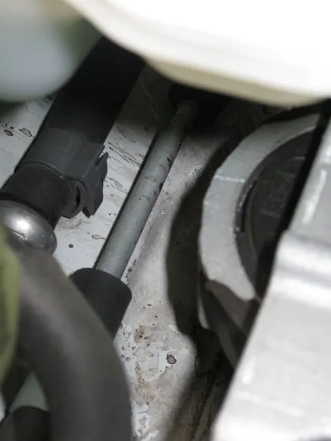

Look for a stain or fluid on the body of the car. The mount is the one that is near the fluid reservoirs. Here is what mine looked like.

I can remember when mine broke. I was at a stop light in wet weather. The front tires were on the wide white stripe marking the intersection. When I took off the front tires spun on the paint, then caught on the road. The resulting torque caused a very loud thud. I checked under the hood later and saw the fluid stain. Otherwise I doubt I would have noticed it until the next oil change.
I had no idea what it was, but the car was in the shop for warranty work and I pointed out the stain to the tech, thinking it was some kind of fluid leak. He knew right away that it was the motor mount. Apparently it is a very common issue with the Mazda3.
Everyone should check under the hood for this. That being said, I doubt anyone would notice a difference in ride or "feel". In fact, the new mount is solid, and you might notice more vibration while idling.
