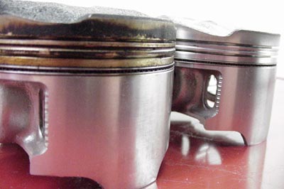

He basically states that engine breakin at low RPM's and "taking it easy" is DEFINATELY not the way to breakin an engine. It's based on the fact that the rings around the piston need to be pressured to seat correctly into the cylinder walls. The cylinder walls have VERY small bits of metal that have stayed on the wall after the honing process. These metal bits are very hard and sharp and can rub a groove into the piston ring as the motor breaks-in. If a groove is made, oil will come up through the rings and possibly into the combustion chamber depending on how many rings have been grooved by the cylinder wall.

Here's the difference between a good break-in and a bad one. Bad breakin on left, good break-in on right.
