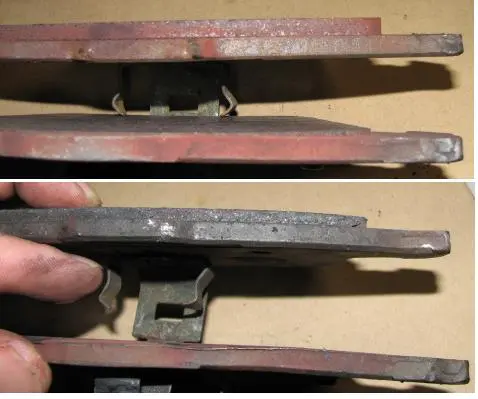

got any pics of the front pads? would be interesting to see evidence of such uneven wear. that's not typical behavior.
were these still the stock pads?
Top pad in each photo is outer pad. Top photo is left front - bottom photo is right front.
The fact that this happened pretty evenly in both sides of a brake system in a car with 6,000 miles on it argues against sticky slider pins. They were greased with high temp grease anyway.
I am guessing that the mass of the caliper caused more of the pressure to be applied to the inner (piston side) pad. Pressure on the outer pad is only applied after the mass of the heavy caliper is moved to pull the pad in. Perhaps there is some flex in the caliper as well.
