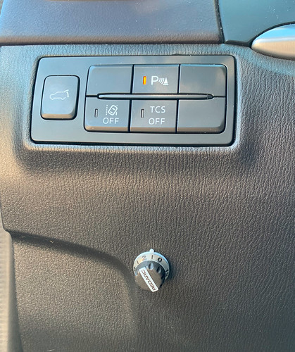

I chose the Redarc brake controller because the only part of the controller that is visible inside the car is an inconspicuous knob. I installed it below the switches on the left side of the dash. I had to modify the back side of the dash panel a bit for the controller's switch module to fit.
A press on the Redarc control knob will apply the manual override brake to the trailer. The knob is easy to see and reach and doesn't affect leg room like many other brake controllers on the market.

Thanks for your reply. I was just curious where and how you installed the Redarc box and override button. And which cable you spliced.
Oh ok. I thought you put the button where the other buttons are. I was thinking about taking out one of the unused button covers and attached the button to that instead of drilling into the trim. Having a giant hole in the trim is probably not great if I ever wanted to sell the car in the future.
