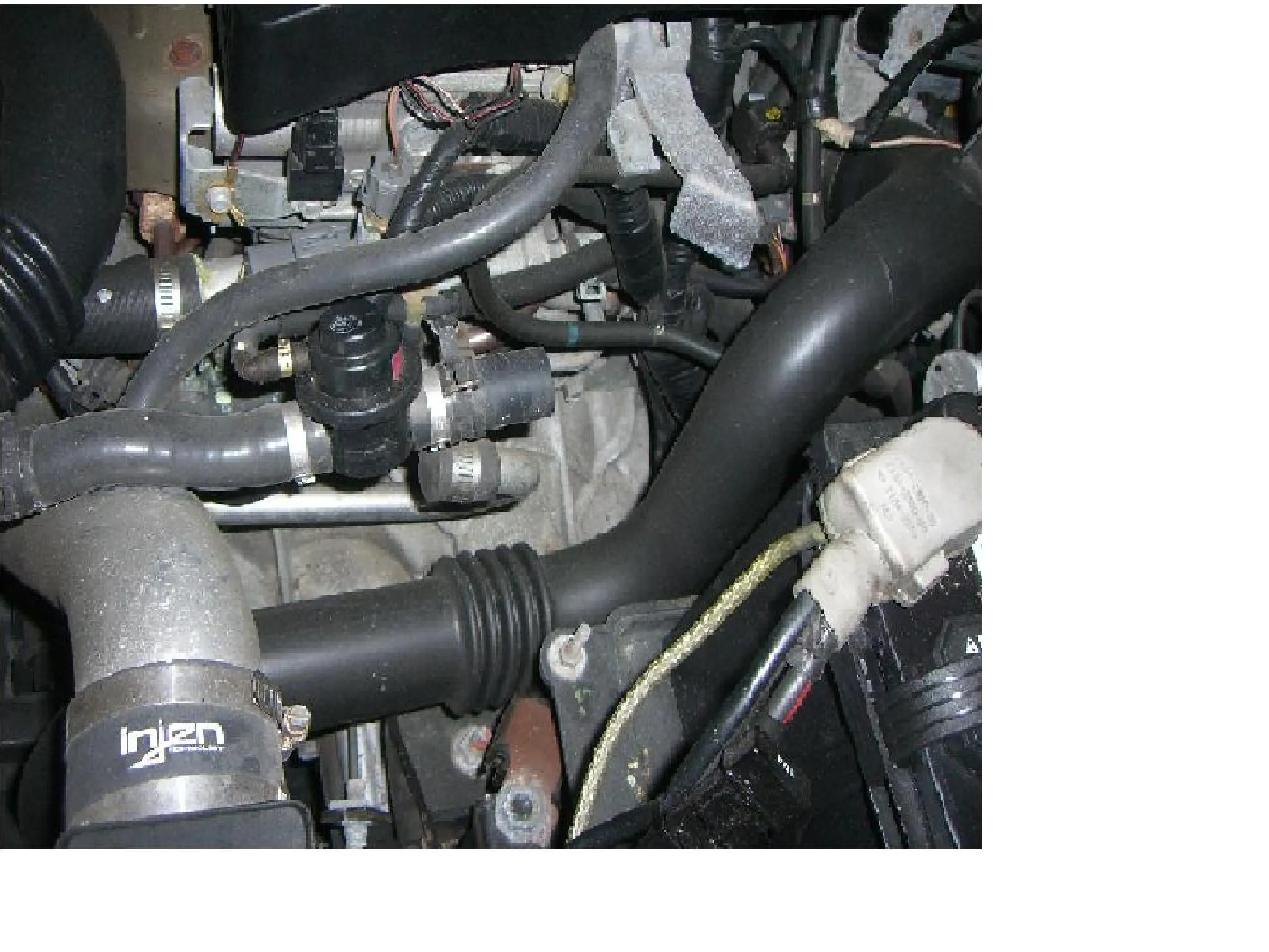

i took a good look underneith the hood of my msp today and noticed that my BPV setup didnt look right...almost like it was disconected...pretty sure its not supposed to be like that but i didnt do it.....i think the previous owner did when he did the CAI
what do yall think?
if the picture dosent show what im taking about please PM me

yup it is...... what the hell was he thinking?
See that little J hook loop thing from the intake? connect it to that.

....any chance that having it like this would cause any harm?
when i fix it......most likely 2moro after noon will it will the car act differently?
b/c im accustom to having it the wait it is...any thing i should look for when i re attach it?

Venting a BPV to air doesn't really hurt anything. Keeps all that hot air out of the intake for one.

i had to buy the spash guard at the dealer cuz the one on the MSP is different then the ones on base model proteges...and it cost me close to 90 bucks.....also i reconected the BPV and car isnt running as sluggish between gears as before with it disconected
