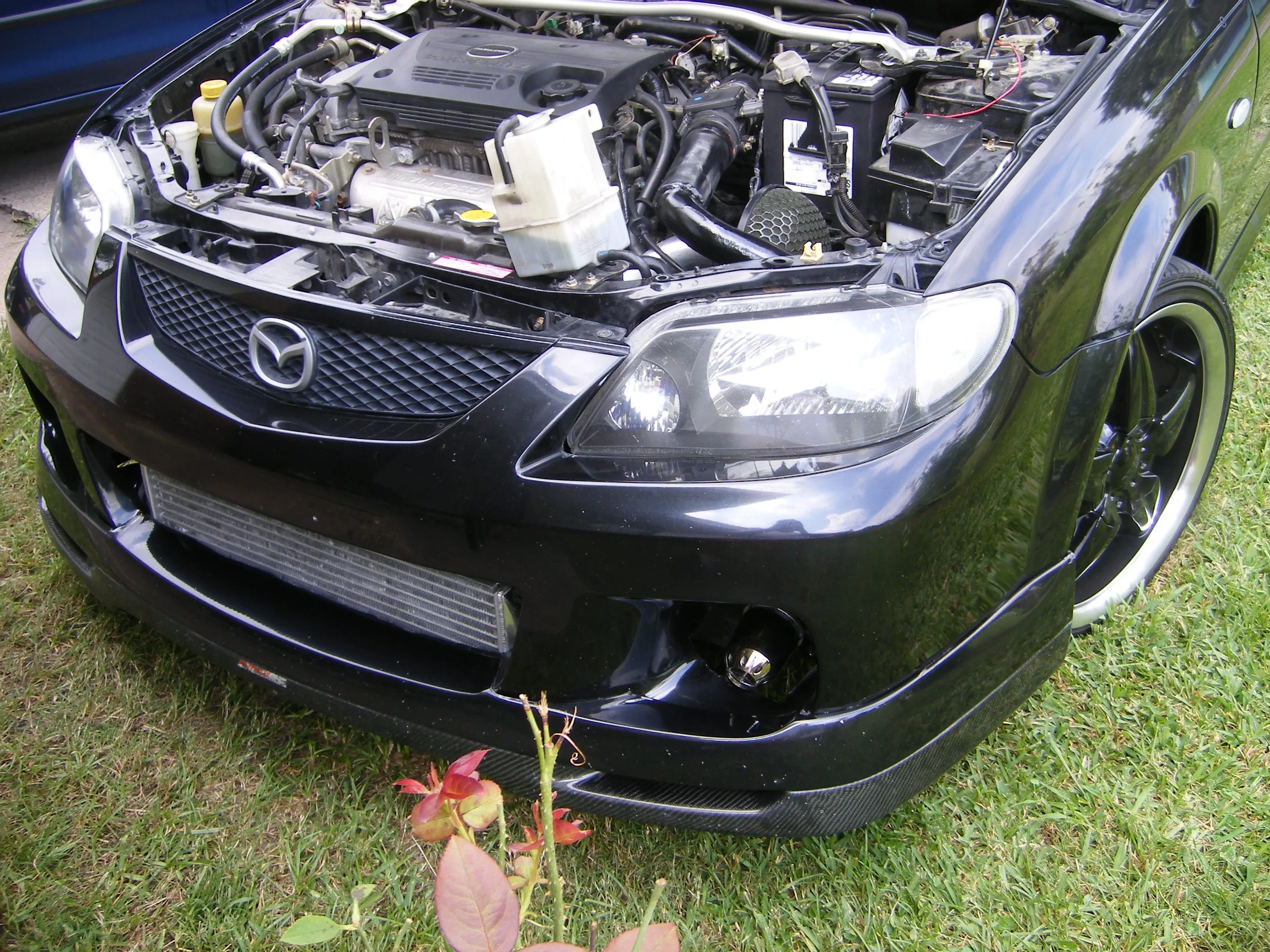

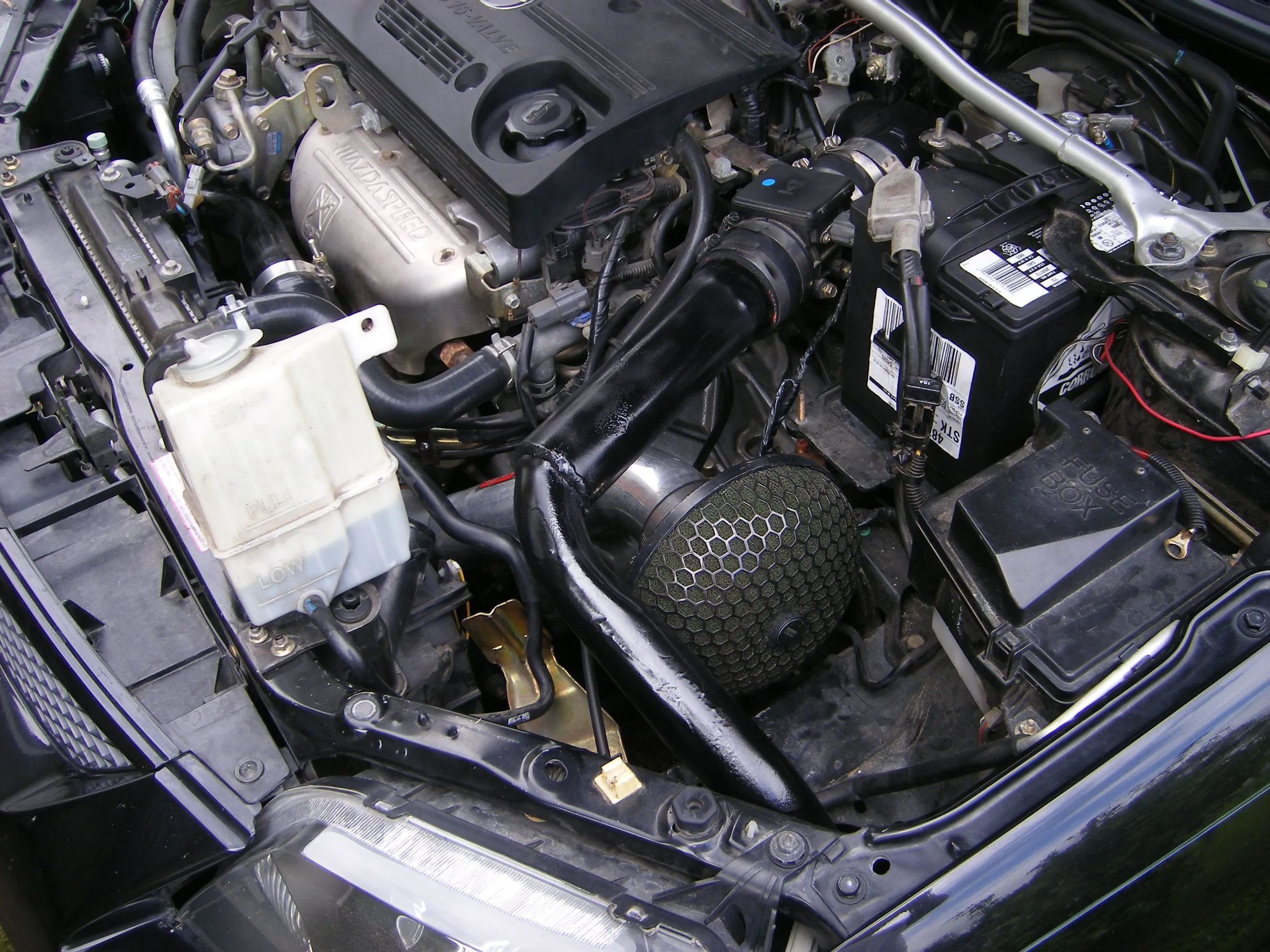

hey wats up guys im kinda new here but i had a question for u guys i have a custom fmic i got the maf on the pipe coming from tb and a ssqv bov about 5 inches from intercooler "yes i took out my right fog light and now have the bov there... back to the question how do i get rid of the turkey?
Hook up the signal line on the SSQV to a tap on the brake booster line, and then run a dedicated line from the nipple on the intake manifold to the wastegate (with no T).
ok. right now i have the line from the stock bpv wat is the diffrence from adding another one im sorry im confused...
That is a weak source for it, and the BOV will work better if you hook the signal line up to the brake booster. The brake booster line is the large 3/8" line that runs from the back of the intake manifold over to the brake booster unit on the drivers side firewall. Make sure you watch out for the check-valve inside of it, and put a T on the passenger side of the check-valve. Hook up your SSQV to that, and then either cap off the T for the stock BPV or run a whole new line for the wastegate.
Should fix your issue there.
In my case just running a dedicated line from the brake booster to the SSQV did not solve the Turkey and stalling issue I was having with just the SSQV hooked up.
Once I went to the dual valve set-up, all issues disappeared and I couldn't be happier.
It's still good to run the SSQV off the brake booster though so you are going in the right direction.
