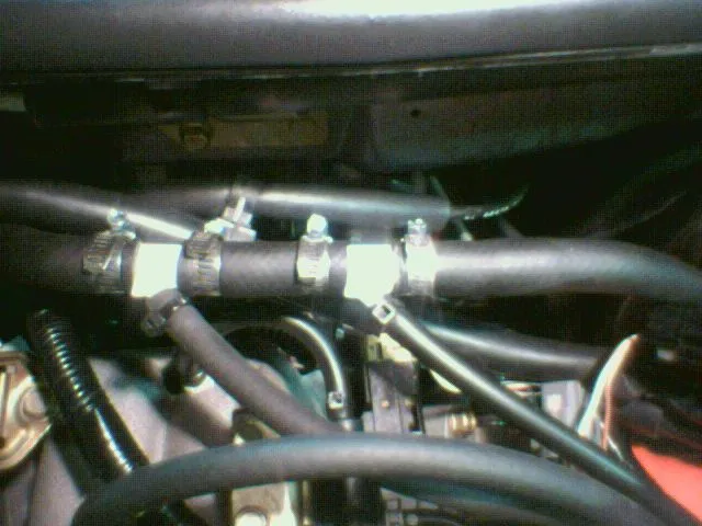

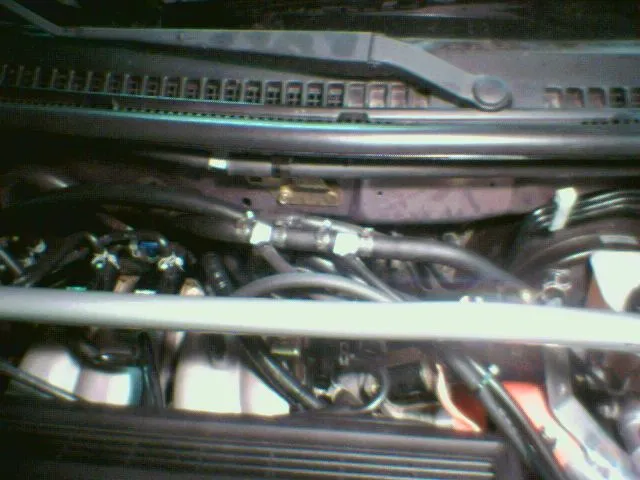

OK ... its all done ... the wastegate now has its own vacuum source and i tapped the brake booster line for the BOV and the BPV. The greddy is a little louder now ... but nothing compared to what i think it should be. Its all whistle and no PSSSSSST.
Any ideas?
Pics if you want them:
