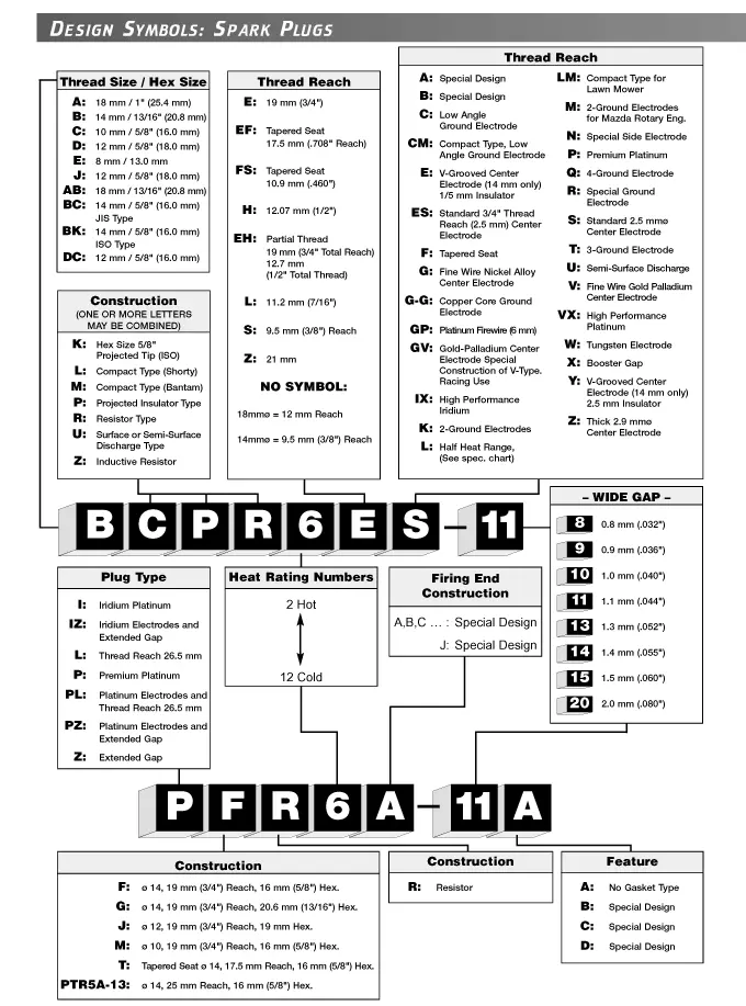

The NGK OEMS are part number BKR5E-11. I couldn't find the translation for that on the NGK site but I'm going to guess that 11 is 1.1mm and that 5 is the heat range. Can somebody who speaks NGK part numbers give the full translation? Anyway, aside from (apparently) a different heat range in what way will these Bosch plugs suck compared to the NGKs?
I am not sure about the part numbers. I would not even think about it. So many posts about problems, I went out and got NGKs and never looks back at bosche since.
Spark plug 411:
