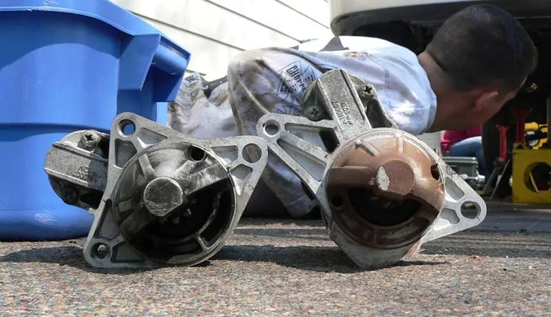

starters are easy to find... most junkers have them.
there's a NICEABLE difference between the 2.
one on the right is the manual
