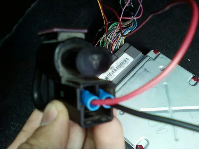

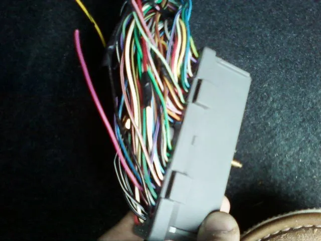

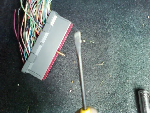

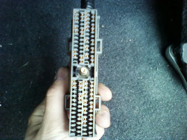

I'll be providing the purtty pics and reporting back on whether or not the CEL comes back after a while. I don't see any reason why it would if everything is hooked up properly. Oh and I ended up just putting some double sided tape on the solenoid and taped it next to the ECU. Make sure to plug the vacuum ports as well. The left input is the power source for the solenoid, I tapped that from wire in pin 97 (white) and the right input is the ground which goes to the newly installed wire in pin 73 (pink).

Why not ohm check the solenoid and then install and equivalent resistor instead of the solenoid? I don't see how the ECU could tell the difference and it would keep your wiring a bit cleaner. Thoughts?
