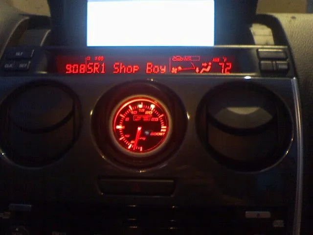

i just installed my boost gauge yesterday. wasn't to hard. i put a 52mm prosport in the center vent. i just took the doors off the vent and glued it so it wouldn't rotate then put the gauge in the housing and put them in and secured them. i will post pictures when its all hooked up. i still have to run the vacuum line and wire the sensor to the gauge. i have one pic i took with my phone but its dark with it lit up.

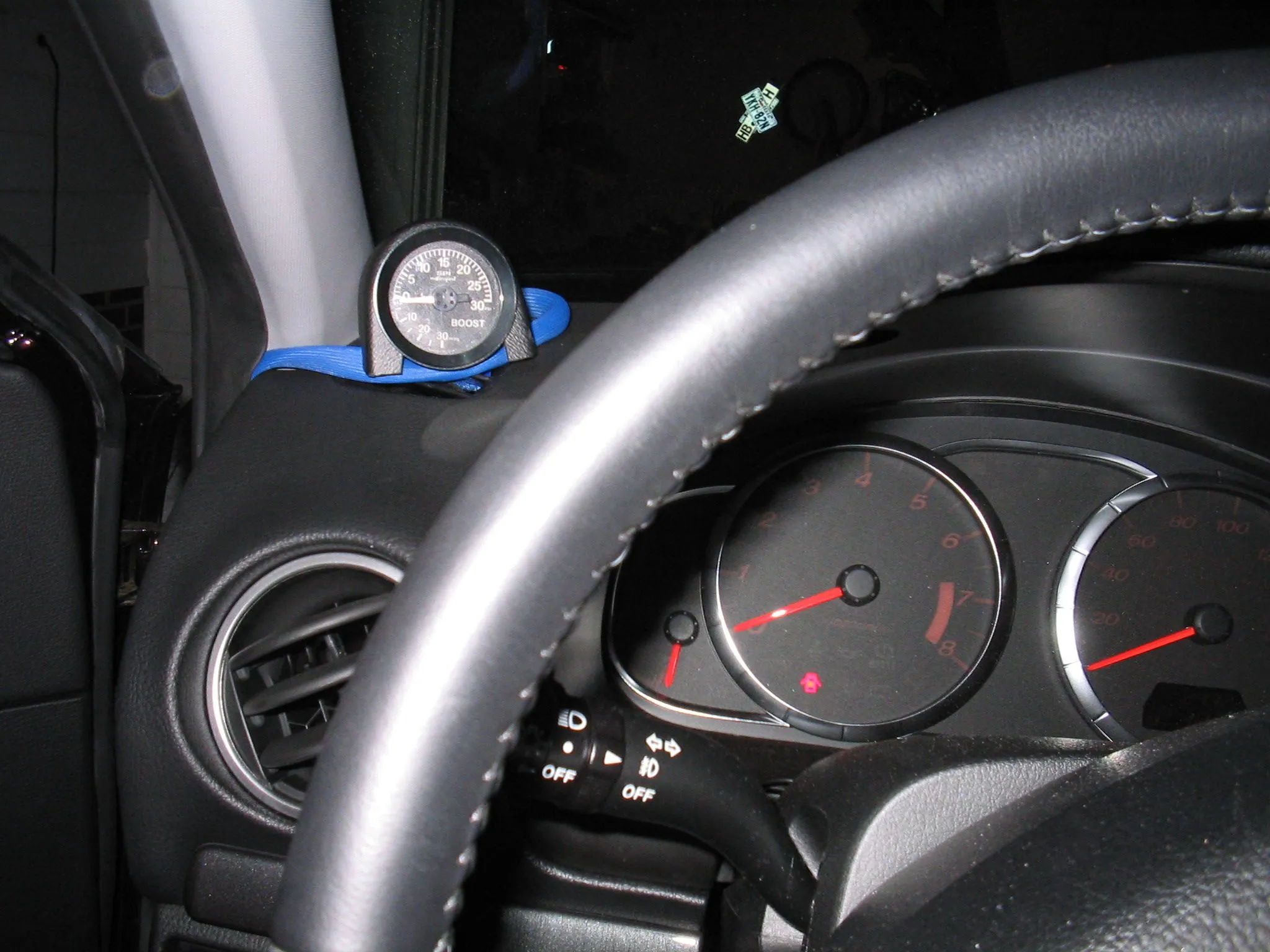

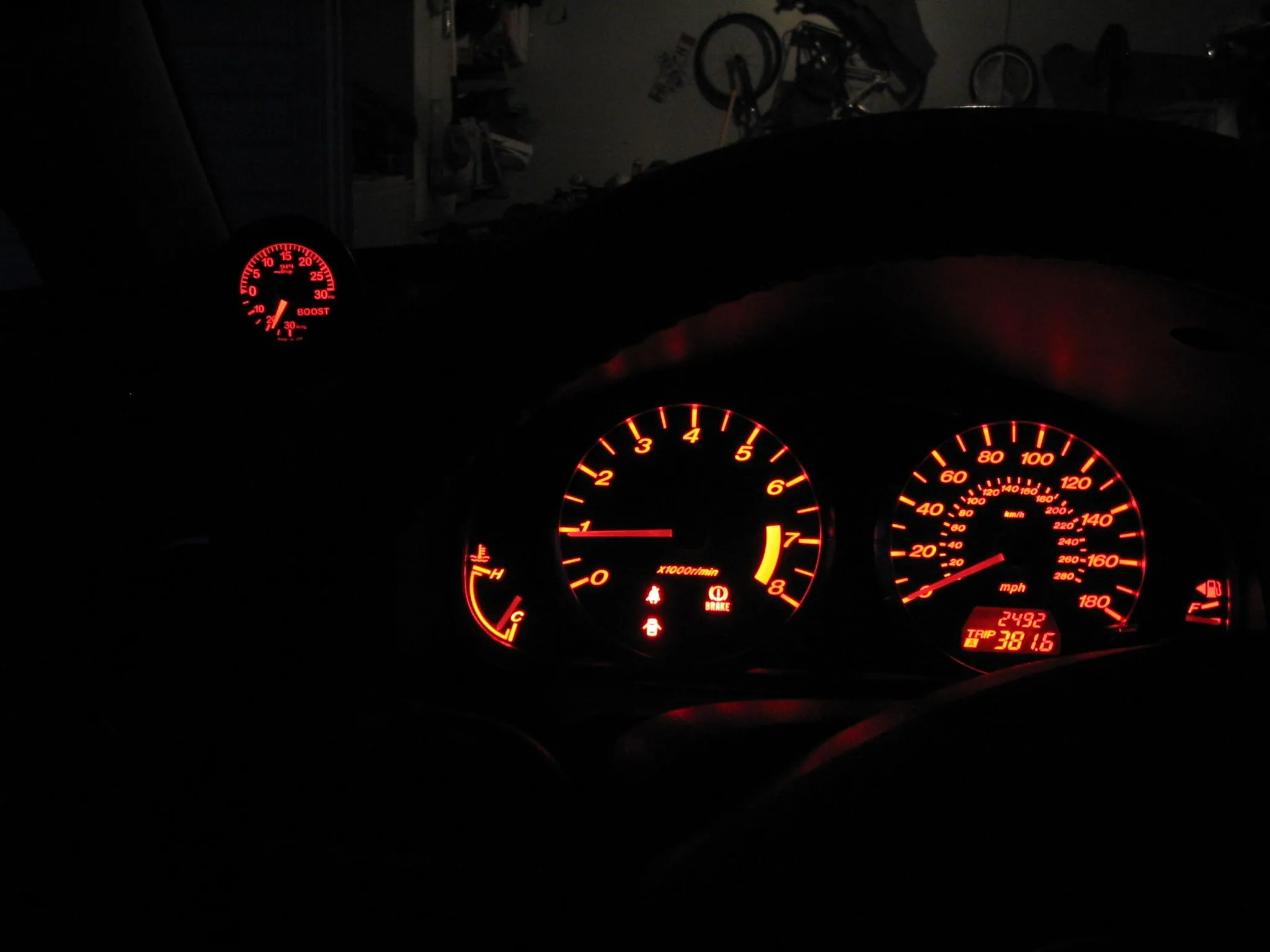

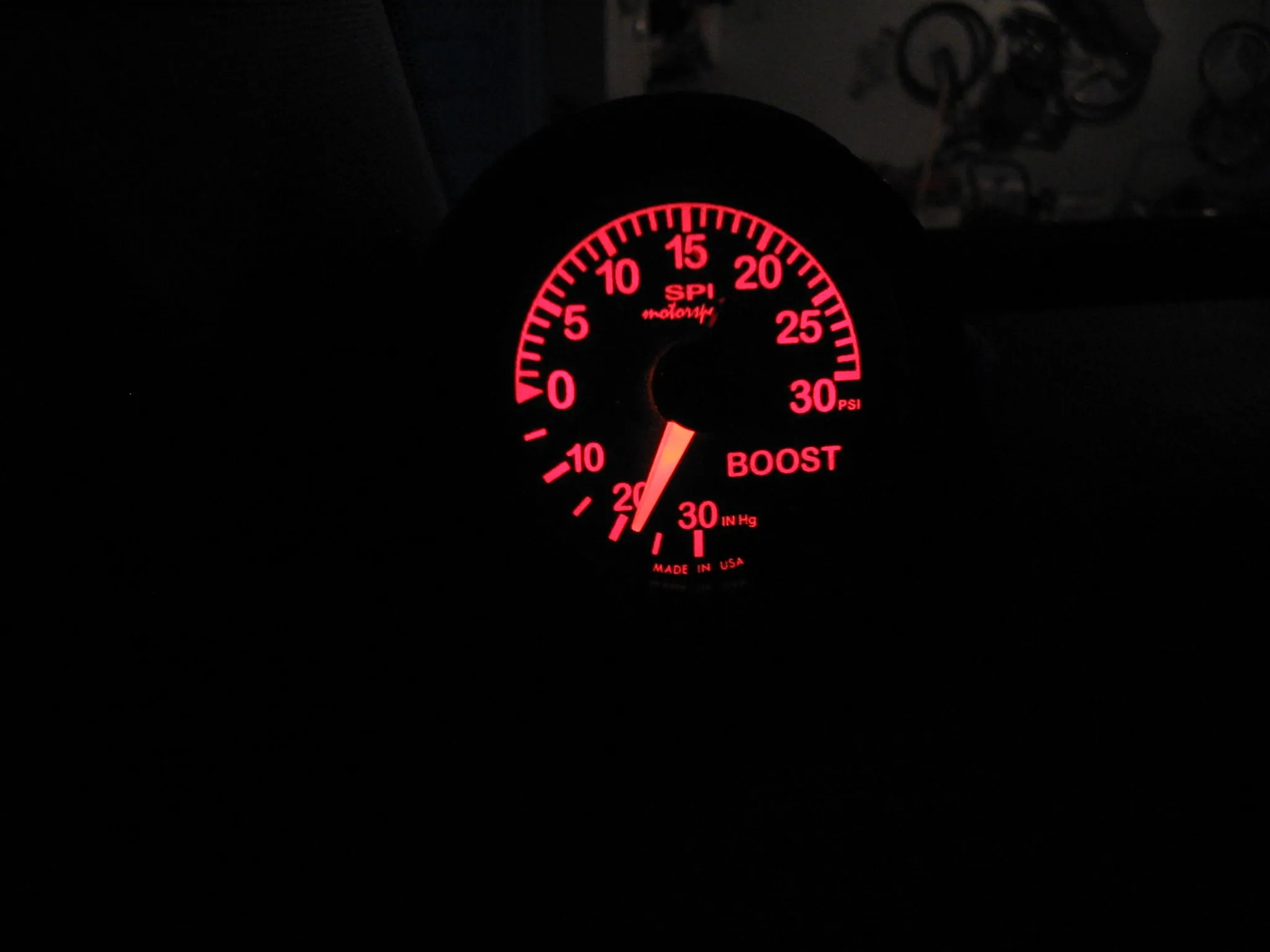

temp gauge install
Anyway had like two paragraphs. this is temporary til I take mine to mold one that will sit atop that vent still allowing air to pass through. the svo has the boost gauge on the pillar the boost gauge was actually stolen from my SVO for this temporary fix.. yes the blue doesn't match just some high heat tubing I had while working on the SVO. couldn't find the black.. Anyway doesn't look too bad the way it is. People look in the car to see wtf it is.
