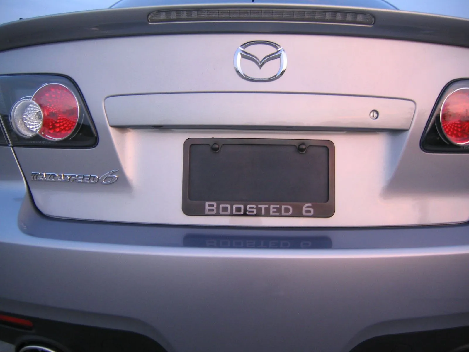

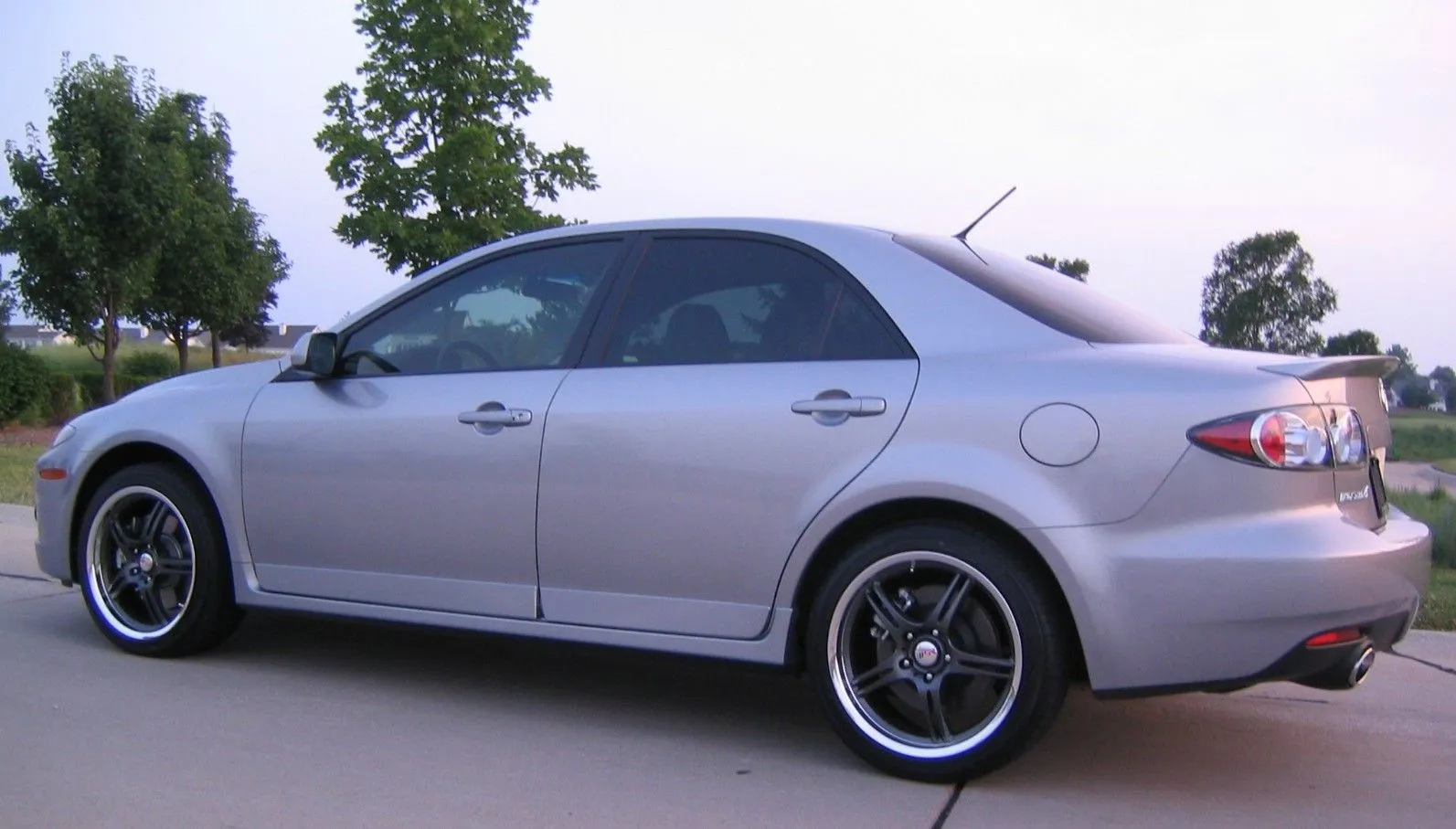

I'll post mine tomorrow. MSR 18" gunmetal 5 spoke.
