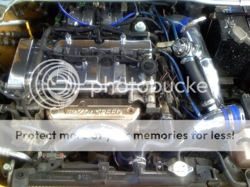

here are the pic i was talking to some guy who told me the fuel presure regulator is the way to because i have the walbro fuel pump with stock injector with no fuel stuff here are th pics
i want to cover those wire that are hanging out like that
it goes nut goes lean to rich

Nice engine bay!

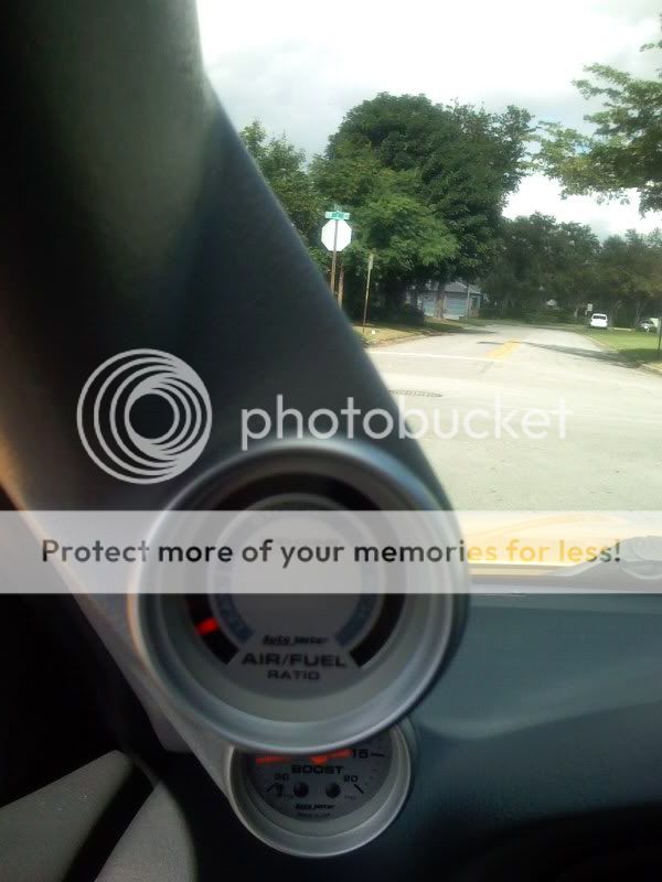

Anyhoo, unless I'm mistaken (I haven't had my coffee yet today), that air/fuel gauge is a narrowband -- which is basically worthless. You need to get a wideband to get a truly accurate reading of how rich/lean you're running.
1. fmic ain't stock. but it's a fantastic addition, and you're piping looks good.
2. Rush ain't mistaken -- you have a narrowband a/f gauge, and they are worthless. I unfortunately have one as well. It should swing back and forth pretty regularly during normal driving and idle. If you're decelerating in gear it should stick lean, and if you're in boost it had better say rich. That's about all it's good for. To really know you're afr you'll need a wideband gauge like the AEM eugo or something similar for ~$300.
