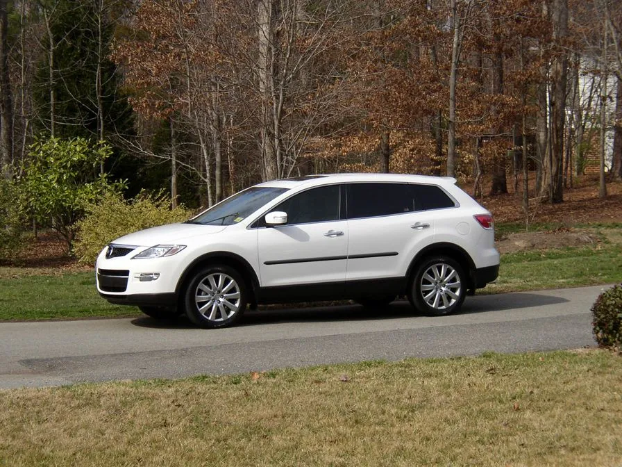

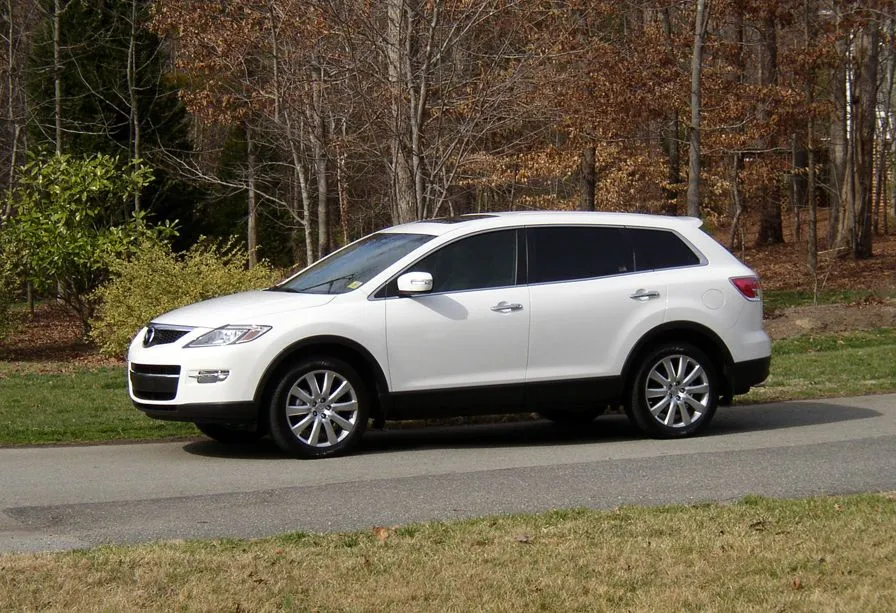

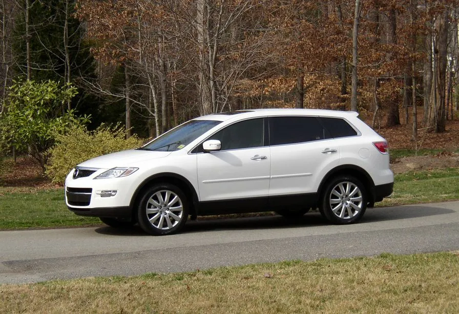

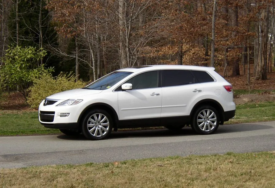

IMHO, 12' was too high on my white GT. Here are photos with no molding, molding at 9" and molding at 10". I'm rotating the photos as wall paper on my computer until I decide on which height or perhaps what other heights I should photo - 9.5"? 10.5"? Other mods: My GT-AWD came with mud guards, I removed roof rails, wired fogs as DRL with 80 watt bulbs, and had front windows tinted 38, rear side windows 15, moonroof and back window 20. I'll probably remove the rear badges later.
I'm going to play the waiting game to see if Mazda comes out with their own. Plus after I acquire a nice collection of door dings, they will tell me where I should install the moldings ;)
indeed, it is a gamble where to put them. As I said in a post way above, you would need 5 of these to keep door dings off your doors. The door ding that I had removed was right at 12 inches, but it could have been anywhere. However there is another type of dent that the molding can protect you from- the rare pole that grandma doesn't see when she opens the door. If you have the molding too low, it will not be the furthest point of the door curve, and you could get a dent that way. Of course, this is a very rare type of dent so it doesn't matter much. Still 9 inches is pretty low- there aren't too many doors that are going to hit your molding if you go that low. I think the people who made the molding for the CX-9 picked a good height for the average ding.

I found the 12" height to be perfect because, after just 1 month, I found a paint chipping on the molding. It could have been a ding there, but the side molding saved it. A simple touch up fixed it nicely.
