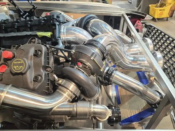

Now the exhaust is going to be restrictive from the exhaust manifold to the tail pipe. ALL of that has to go and be replaced. We have a talented local guy, who specializes in import turbo and exhaust. His stuff is a work of art and costs accordingly. Check out Walker Morgan on FB. He built my custom headers for my race car. An absolute piece of art. Here is a typical turbo build of his. OP will have to get off his checkbook for this mod too....
