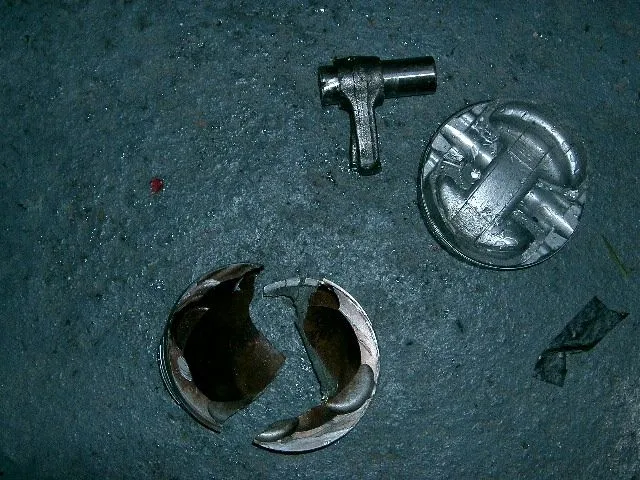

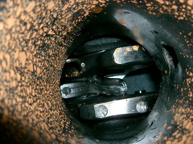

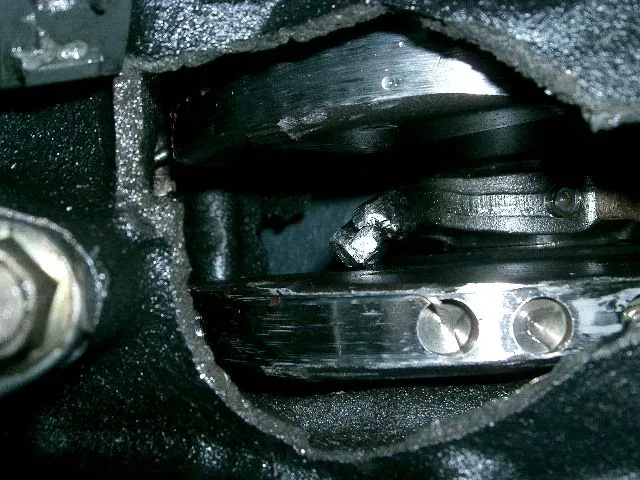

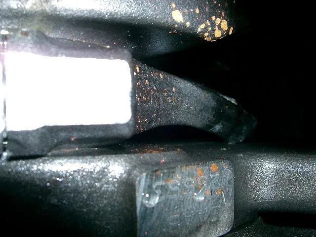

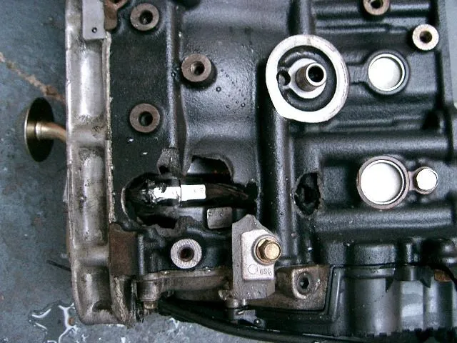

New Pictures added (digital camera), better detail, engine is out of the car.. (under the old pics as attachments)
For the people that doesnt know what happened:
I was boosting 11psi and found an STI on the streets so I decided to test drive my tune. For my surprise, I won all 4 races agains the STI. All 4 where not from the hole but rolling on 1st gear.
Anyway, this I was just racing alone...I left the STI way behind. I went WOT in 4th gear, the A/F was showing 13:1 but the EGT was showing cold exhaust temps ~1150, so I kept flooring it and BANG...the engine died on me, lots of smoke, vapor and oil all over the place.
Now, this is what I still dont understand. I found something interesting...
My intake cam was broken where the sproket is and 1 intake lifter (if its that how is called, first pic). Looks like the cylinder 1 got the valves stuck open. Both rods 1 and 4 broke, piston 4 broke and block damage all over the place.
I must admit that on the mornings, the was a ticking sound comming from the cover, like a lubrication problem on the cams/valves...so all cold starts had this ticking sound, but gone after a couple of minutes.
I really dont know what happened!!
Enjoy the crappy pictures...I lost my digital camera...so all I have is the handycam to take pics.
