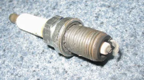

Okay, I'm swapping out my plugs (wires are still within spec) and plan to just go with the 6Es unless anyone sees a reason to go with the hotter 5Es. I've attached a picture of one of my plugs after about 22,000 miles. I guess the hotter plug wouldn't have such white tips?

Yeah, I'm going to more and more track days, so it's spending more and more time in the high RPMs, but the plugs seem to look good, so I'll stick with the 6Es, thanks.
