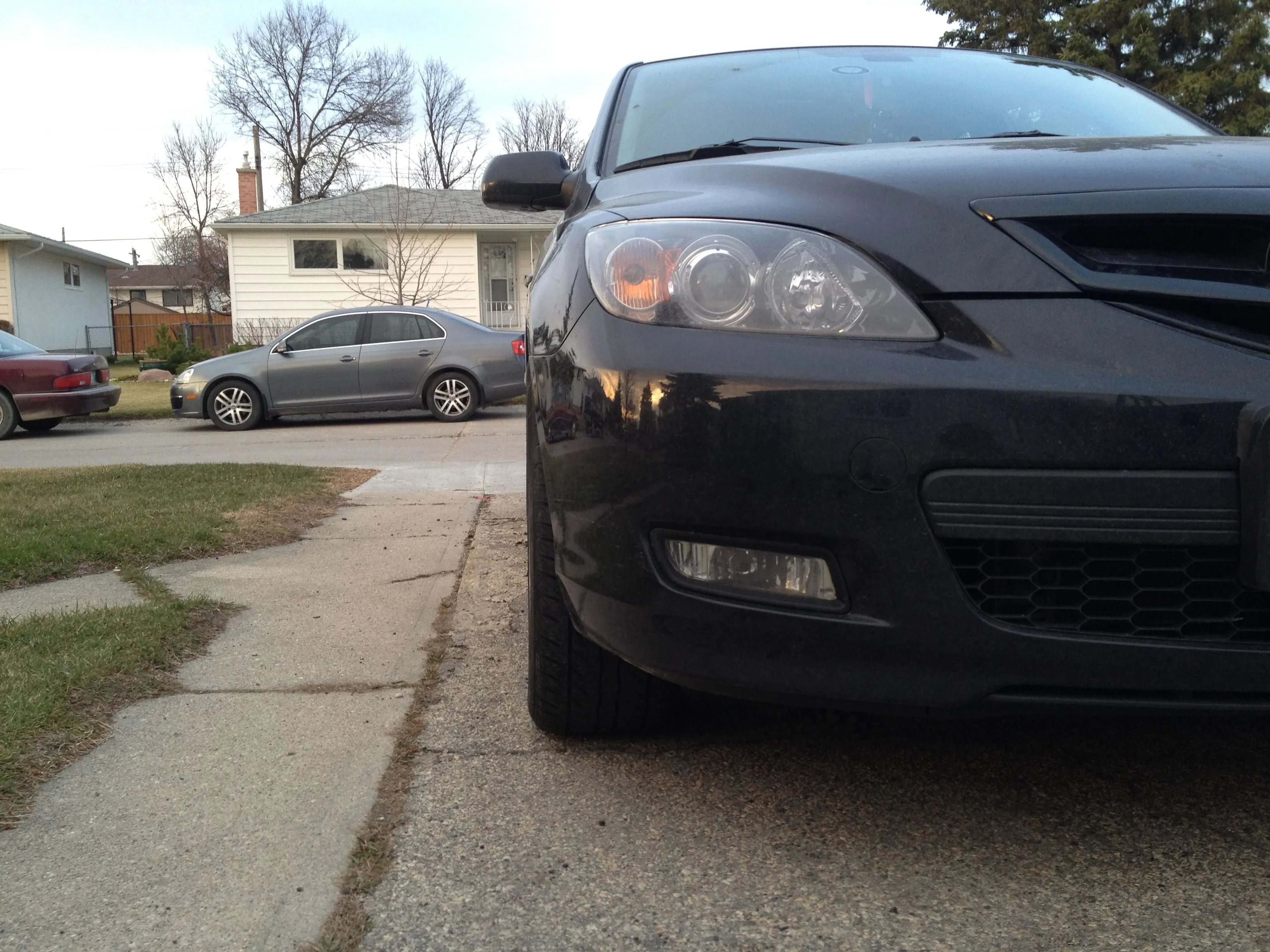

So, I got a set of RX8 18" wheels, on them came a set of 245/45/18 Dunlop sp sports.
After researching A LOT on the web for some info on whether or not they would fit I just gave up and went with a scientific approach to it! I put them on!
So, after having them on for a day, it's only rubbing when going over really large pot holes or big bumps too fast.
If you're careful with it, you wont have any problems at all!
Here are the pros:
Wheel gap; GONE!
Aggressive looks; check!
Cons:
You have to be really careful with your driving.
Speedometer is 6.4% off from the regular 205/50/17 tires. ( I solved it by putting +6% speed in my scanguage II)
Some pics here:
