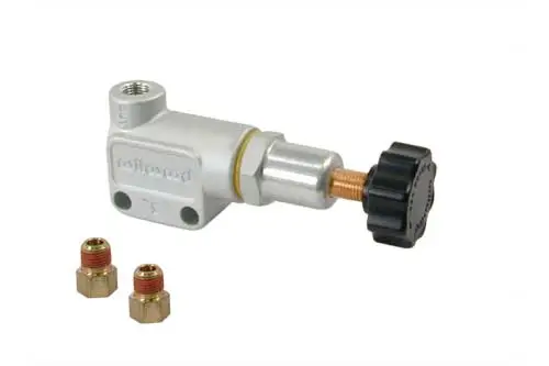

um. I tend to lock up my brakes, different wheels depending on the corner. purely driver error. But I found that this littil thingy helps with the "balance" no mater what pads im using. oh and a pair of these other thingys helps with the fad and wear.
but there is different ways of doing everything. Remember that this is for fun not a scientific journal(fight)

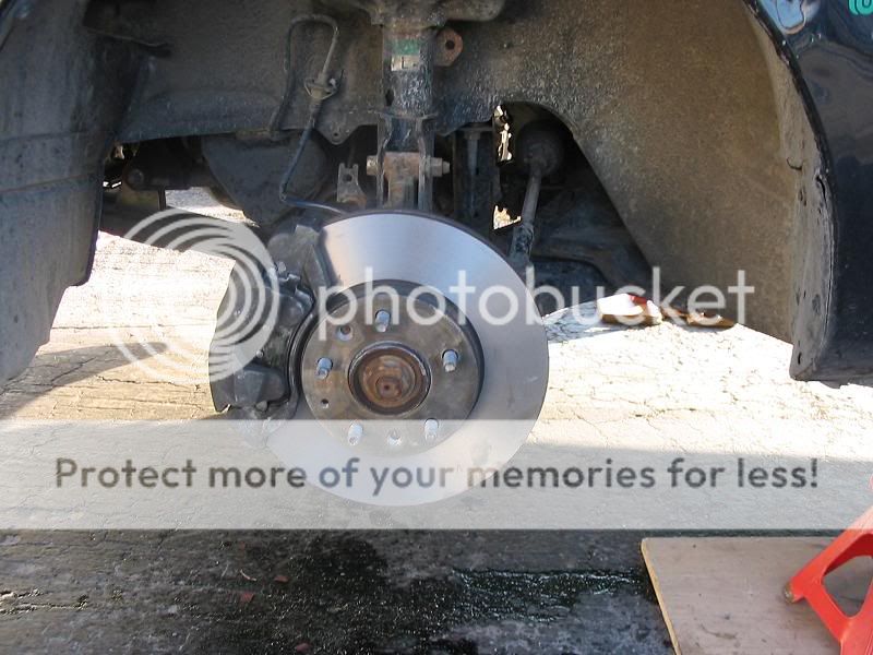

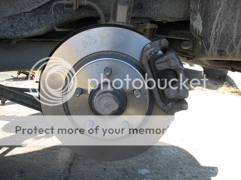

What more information? Isn't it common knowledge that all 6s brakes fit on the Protege? Here in Quebec, you'll see a lot of Protege with Mazda 6 front brakes. My race car have them all around, since I don't have a hand brake, I can put them in the back. The 2006+(bigger) fit and the Mazdaspeed 6 as well.
Here's some pics of the ones that was on my race car:
completly bolt-on! I did that in 2005, this is why I thouht it was common knowledge.
are you using the 6 calipers? Do you need a different master cyl for what I can only assume is a higher volume of fluid moved?
You HAVE to use the Mazda 6 calipers if you want the disc and vice-versa! You don't need to change the master cylinder. You can upgrade it to the 92-93 929 master if you want, but it's not needed.
