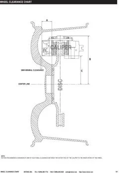

I know the Brembo brake kit offered by SU will not fit the stock wheels but they offer another kit by Rotora. I was wondering if this kit will fit the stock wheels on our MS3. I know they will fit under my aftermarket wheels which are 18x8 but my stockers are used for winter and I don't want to have to switch Calipers for winter. If any of you smart people could help me out that would be great.
Clearance Dimensions: A: 33mm, B: 187mm, C: 114mm (use the attached image)
