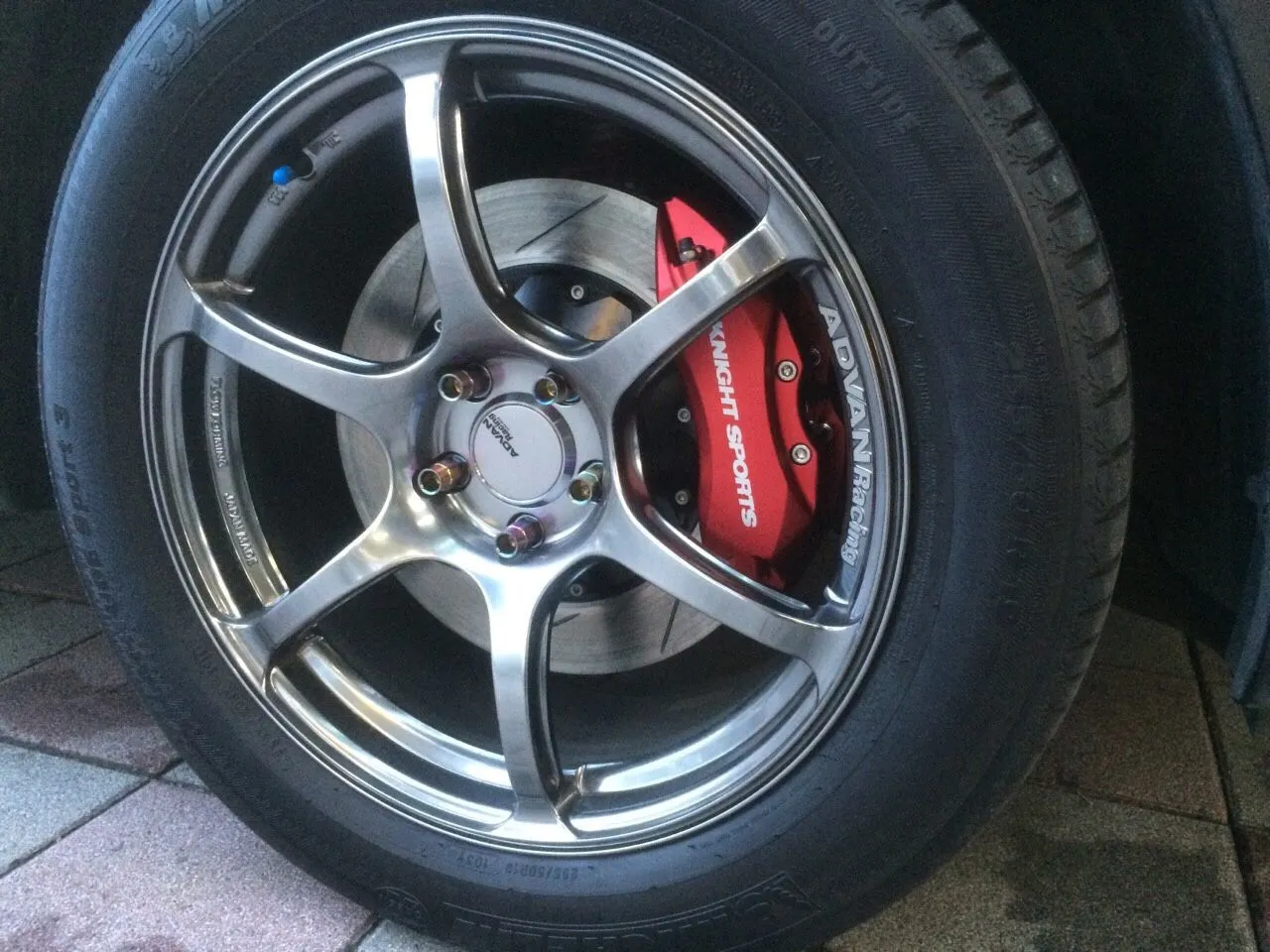

I got Knight Sports 356mm front 6 pot brakes from Japan. I also changed the rear stock pads to aftermarket.
They brake really well but theres a bit of squealing when brakes are warmed up. I will try different pads after these kit ones wear out.

Thanks for the pic and review.
Knight Sports kit seems ok but its quite expensive for a 4 pot system. I remember there was a Brembo kit on a Mazda show CX-5, does anyone know if that kit is available on the market?
Edit: whoops i didn't see that the kit was a 6 pot, ok price seems more reasonable

The brakes are good. Stainless steel brake lines would be an excellent compliment to the oem system.
I wouldn't say that the performance gains are limited to track, the kit comes with slightly more aggressive pads, I'm assuming a bigger disk/rotor and stainless steel braided lines with new fluid. All of which have an effect on stopping distance, be in direct or indirect.
As far as brake balance, lets look at the details of what drives those figures: Size of rotor, caliper piston diameter, pad coefficient of friction and tire, for the purposes of this discussion we can assume tire will stay the same and eliminate that from our list.
Most BBK will use a larger rotor than stock and to offset that increased torque, smaller caliper pistons are used to reduce clamping force (Pressure = Force/Area therefore, Force = Pressure * Area). We know that the 6 Pot system uses much smaller diameter pistons than the stock caliper, and it would make sense to me that the combined area of the 3 pistons (on one side) is at least the same as the area of the stock piston, so the effect of the bbk to brake bias should be minimal, especially since the brake line pressure will always be the same. If the bias is noticeably higher in front, you can compensate by using a more aggressive pad in the rear calipers, which is recommended practice.
All that being said, nothing wrong with stock brakes, but I like my brakes to feel and look more aggressive and BBK is an option for people like me.
Bigger discs and more powerful calipers can not shorten braking distances because the OEM brakes are capable of bringing the tires to the limits of adhesion quite easily and continuously from 125 mph to zero.
Right, but wouldn't you agree that bigger discs and more powerful calipers would bring the tires to the limits of adhesion faster than stock equipment? You'd be at the limit sooner therefore minimizing time below threshold of tire grip. Also, brake discs are essentially heat sinks that convert kinetic energy into thermal energy, larger discs will can absorb and disperse more thermal energy therefore more resistant to fade than smaller discs. 125mph to 0 continuous stops will definitely pull brake fade into the equation.
