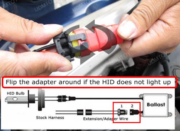

Sorry for reviving an old thread, but I have a similar issue......I recently had to get new headlights & in an effort to save some money I opted for aftermarket instead of OEM. My guy at the shop did tell me I'm gonna need ballasts cuz the aftermarkets don't come with em, so I figured I'd just get an HID kit while I'm at it. I've used ddm before on my honda & loved it so I went & got their 55w 8k. But my issue now is after going through the connections 3 times, I'm not getting any lights. Anybody has any suggestions?
Here's some troubleshooting ideas:
1. Check for reverse polarity? You have your OEM connector to aftermarket ballast reversed?
2. Did you check to see if the headlight fuse didn't blow? If you reversed the polarity you may have blew the fuse.
3. Also use a meter and check if current is going to headlight connector.
4. Faulty OEM headlight relay? I doubt this, but should check if none of the above works.

my issue was two folds, first I had the polarities reversed, when I flipped the connectors, it still didn't work.
upon a more detailed inspection, I noticed my CX-9 (non OEM hid) have H11 connectors but my aftermarket kit hid ballasts
came with the more popular 9006 connector.
my OEM H11 fit into the 9006 ballast connector and looked like it was connected but in reality it wasn't making electrical contact at all.
the narrower H11 leads center to center didn't match the wider 9006 socket center to center.
I had to get some 9006 to H11 adapter cable,
http://www.ebay.com/itm/2x-9006-To-H11-Pigtail-Headlights-Conversion-Connector-Wiring-Harness-Plug-Cable-/261230919931?hash=item3cd29380fb&vxp=mtr
then voil, it worked.
