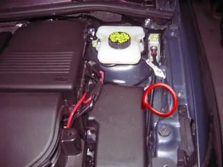

thanks for the response! I decided to just do it without removing the bumper... checking this thread was the last thing on my agenda before getting my hands dirty, so I'm about to take a stab at it.
The spots I think I'm gonna try for the ballasts are *these* spots (see attachment) each side of the engine bay... I swung by Lowes and got some 'industrial strength' velcro tape to mount them there.
We'll see how it goes... thanks again!

Yes.. i thought about that spot as well.. but moved bit backward.. for *cooler* temperature...due to windshield vents...

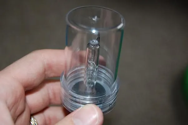

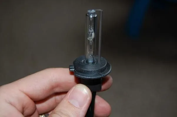

okay, so this is a retard question... 100% positive of that, but forgive me because up until last night I've never seen a HID bulb in my life! :)
I was trying to figure out how in the hell to make the bulb fit inside the housing, looks like it was impossible.... until I THINK I realized the huge ass plastic shell the bulb is in, is just to protect it for shipping purposes, d'oh!
But I want to make sure that #2 is the correct way to install the bulb in the housing... like I said, I never touched an HID bulb before and I wasn't sure if the huge ass plastic shell thinger is meant to stay or go.
(oh, and on a different topic, I'm pretty sure the kit came with those adapters I needed, FWIW)

(wiggle) haha... all of those *clear* plastic covers/shells need to *go*...
2nd pic you posted is the *ready to go* stage ...(wink)
edit: i can't see the adaptor on your pics..
another tip.. when you put HID bulbs in and try to lock in with metal clip..
make sure.. HID bulbs stay in *lock* position before metal clip *click*..
(the biggest plastic tab needs to *lock* in H7 housing)..
what happped to me was.. even though metal clip locked.. HID bulb was not positioned *right* and i had to *redo* the one side again.. lol
you can't see them in pics because they're not there, haha... there were out in the box at the time, but I got the one adapter put on the bulb now... pretty much looks just like the H7 bulb that came out, and crossing my fingers, looks like should be held in by that metal wire just like OEM.
Thanks again!!!! pics'll come later tonight if nothing else :)
