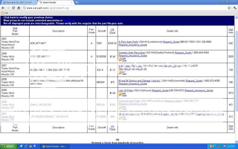

HERE IS THE BEST WAY TO GET AN OEM HITCH FOR 100 BUCKS. CAR-PART.COM
It looks like there are a few places in the country that have one in their yard. Course it may have some rust, just call them and ask about it.
