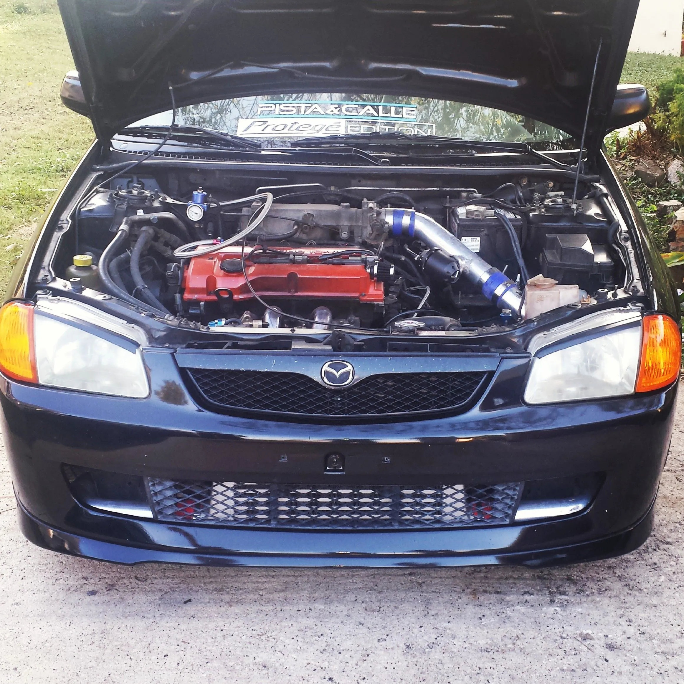

I forgot to update I change my front bumper for JDM one I have now a bigger intercooler have done some weight reductions and its lowered
