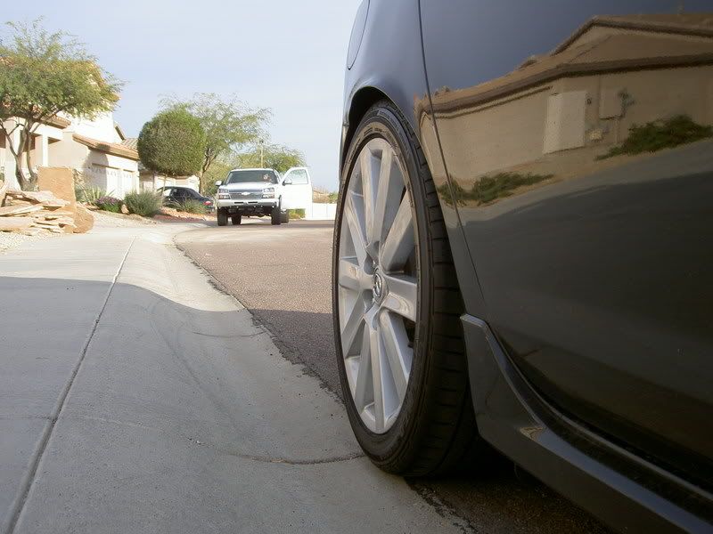

a while back some of you might remember that i installed eibach 15mm type 4 spacers with the stock wheels. the stance looks incredible, however, over the span since i've had them installed i've noticed that there are a few bumps in my travels that if i'm at speed, and turning right in any capacity, there is a portion of the front of the driver side rear fender that hits the tire a bit. it pulls the inner lip out and makes it even more vulnerable to getting hit with the tire again. it also pulls a little bit off of the tire.
i've successfully pushed the piece back in place with some heat and a nylon brush handle, but it's happened twice and i think the combination of my weight, plus turning and making a bit of body roll, PLUS the bump is making this something that has to be addressed ASAP.
so, i am going to stop over at a trusted place and have them look to see about rolling my fenders. i'd do it myself but i'm willing to pay these guys as i know they have alot of experience.
has anyone else had this issue with the front of the rear fender hitting the outer portion of the tire a bit in certain situations? if you are looking at the driver side rear wheel, the spot would be at like 10:00 or 10:30...in that range. and, it only happens on the one side which makes total sense because i'm alone most of the time in my car (we take my wife's car or the dog's montero most of the time)
also, any pics of the finished product would be welcomed. i'm curious how much in terms of radius the rolling goes, typically.

i don't think i need to pull them at all, but i do think that i need to somehow push the inner lips up and in, like, at a very slight angle- nothing crazy.
i took the car to a local trusted place and they were not happy with the prospects of rolling the inner lips. they were very worried about it cracking.

have you checked that pinch weld (or whatever you want to call it) where the bumper attaches to the quarter panel inside the fender well? after going from a 245/35 back to my stock 215/45's with my spacers and the added sidewall, my tire is now catching on that piece thats sticking out. im going to track down a little electric saw this week and trim it down some more.
when i have the wheels and tires off i will take some pictures of my fenders. aside from that spot, if you want to roll the inner lip (the part that sticks straight out) completely flat to the inside of the outside of the fender, the paint WILL crack, lets be honest. initially, i had the inner lip bent in at a nice 45 degree angle, and the paint didnt crack, but i needed more room.
