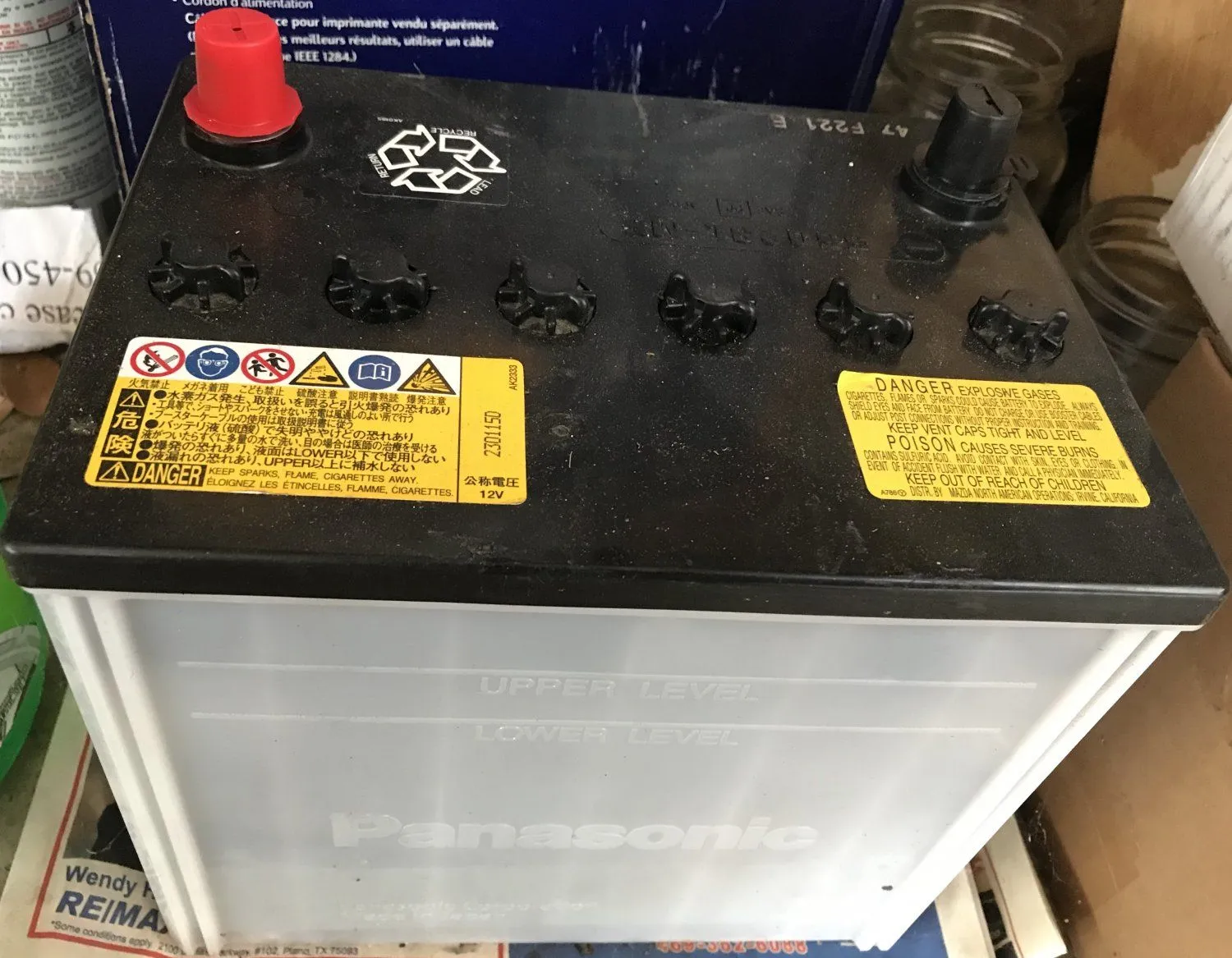

Np! Upon googling that, it says it's group 34. Another way to check would be to find your auto parts site and input your car year and model #. It should spit out the exact battery group type you need. Should give you a head start on researching. Good luck! :)
Hey!! Do you know if the US and Canada is the same model for the 2016 GT??
CX-5 uses Group 35 battery. BCI group battery size is used only in North American market including Canada. You won’t see any “Group 35” wording on factory Japanese Panasonic battery.
