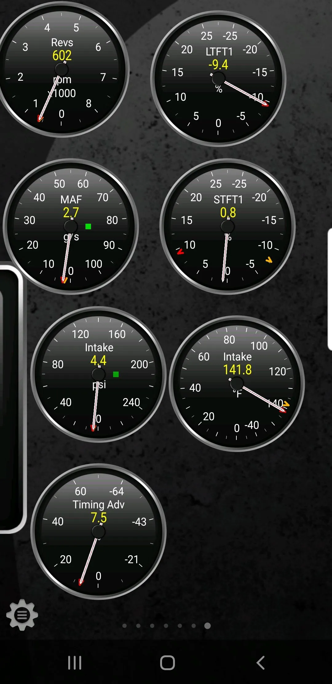

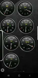

Current #s with tune. Iats are higher at idle due to short ram intake so manifold pressure might be lower but that varies on temp and altitude anyways
Interesting. Your tune remaps injectors a bit rich at idle--almost -10% LTFT.
Nonetheless, your MAP pressure should be about the same as mine (similar elevation of 700' +/-). You're at 21 in. vacuum. Check. Your MAF is 50% higher than mine, at 600 RPM. hmmm.....

Possibly due to the SRI. It flows more but I can put the oem airbox back on before I leave tomorrow it takes like 5min. But my oem box has a jbr high filter. Also my trim sunset based on my driving so richer make sense since I tend to do a lot of WoT and high rpms.
