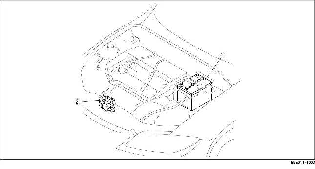

Hey was that hard to install? with the tight squeeze and all? Would the speed have the same setup?
Was REALLY easy to install. The alternator on the NA 3 (2.3L) is located on the lower front side of the engine block and is really easy to get to once you remove the lower splash shield.

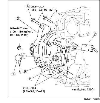

Alternator Removal
1. Disconnect negative cable from battery (trust me, do this!)
2. Take off lower splash shield
3. Remove accessory belt off of alternator by moving belt tensioner
4. Disconnect cable from alternator by removing nut, then cable
5. Disconnect plug from alternator
6. Remove alternator by removing the four (4) mounting bolts holding the alternator on to the side of the engine block
Installation is reverse of removal...
Not sure on where the alternator is located on the MS3 but that's the way it's done on the NA 3 (2.3L). Hope it's as easy for you!
