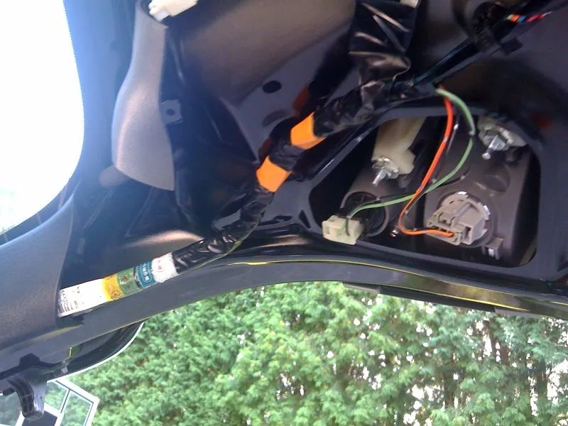

Having a real hard time figuring out how to install some backup sensors I bought. Does anyone know if I can find the backup wire anywhere else besides in the trunk lid?
I took off the trim on the hatch (see pix - orange wire) and all I see is that it goes into the headliner, but can't figure out where it goes from there. I really don't want to take out the headliner just to get to the wire.
Does anyone have a wiring diagram for installation?

In the past, I ran the wire (+) all the way to the backup light.
The ground can be tapped anywhere to the body (negative).
Use some oil to lube the wire so that it is easier to run it through the
rubber boot.

The use of liquid soap (such as Dawn) is a better recommendation for lubing wiring through a harness or boot. I worked for GM 14 years (often routing harnesses), and there they avoided lubing harnesses with oil because over time it degrades the insulating sheaths over the wires and neutralizes the adhesive of the outer tape/cloth layer that keeps a harness assembly bound together.

there is lube made especially for pulling wire. Dish soap can turn into glue after a while which is a problem if you need to get the wiring out.
