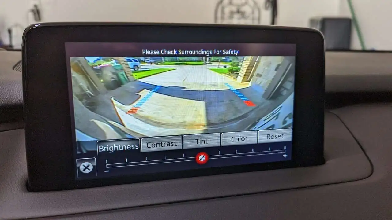

Tap on the arrow at the top right corner of the screen

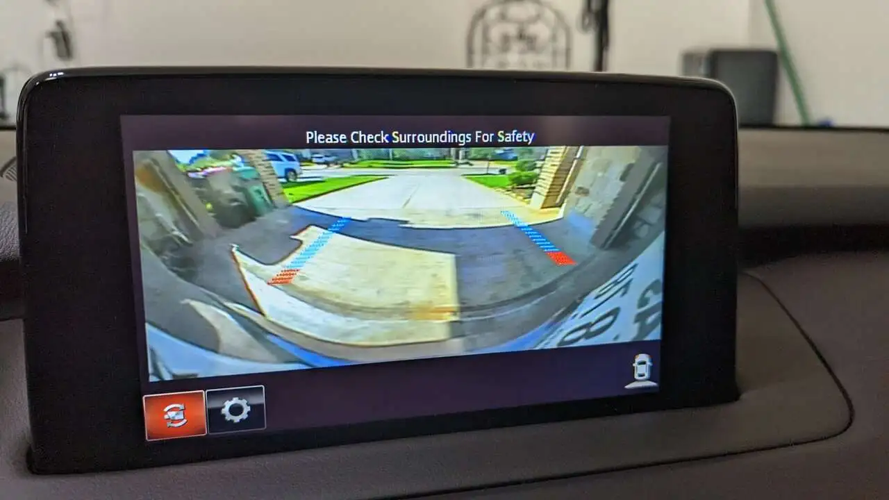

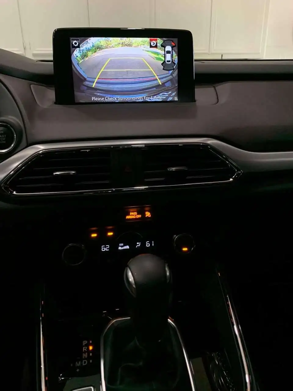

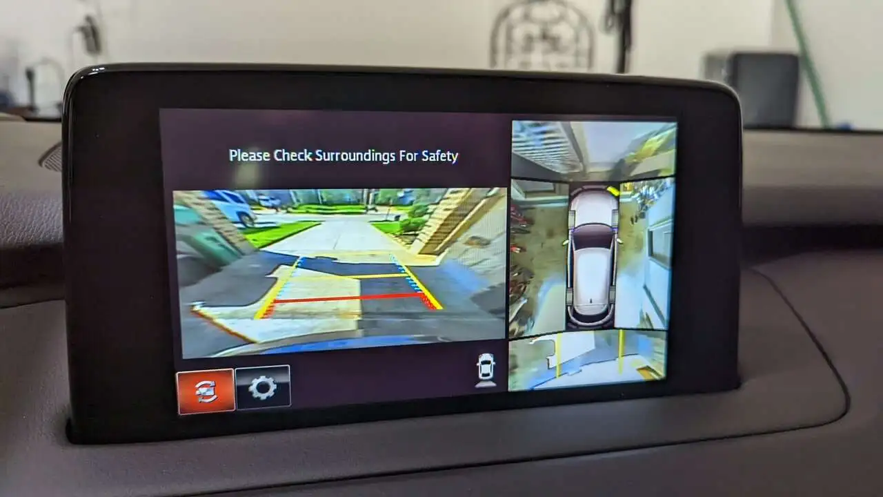

I tried unfortunately mine looks like this without the arrow. Only settings
I have a 2019 gt with front and rear sensors that do beep

The photo in the first post is from car without 360 camera. (Like my 2018). Not sure on yours where the display of the sensors would be, or if it is even an option.
Looked at the manual. There is suppose md to be a setting in the infotainment setting section to turn the parking sensor display on and off. ( not in the reverse camera setting).
It does not look the same as in the first pjoto with 360 camera but you should still see a top view of a car with indications of sensor detection.
Thanks, I missed that section. I have the front view with 360 on when I turn on the car. All good this will suffice.
