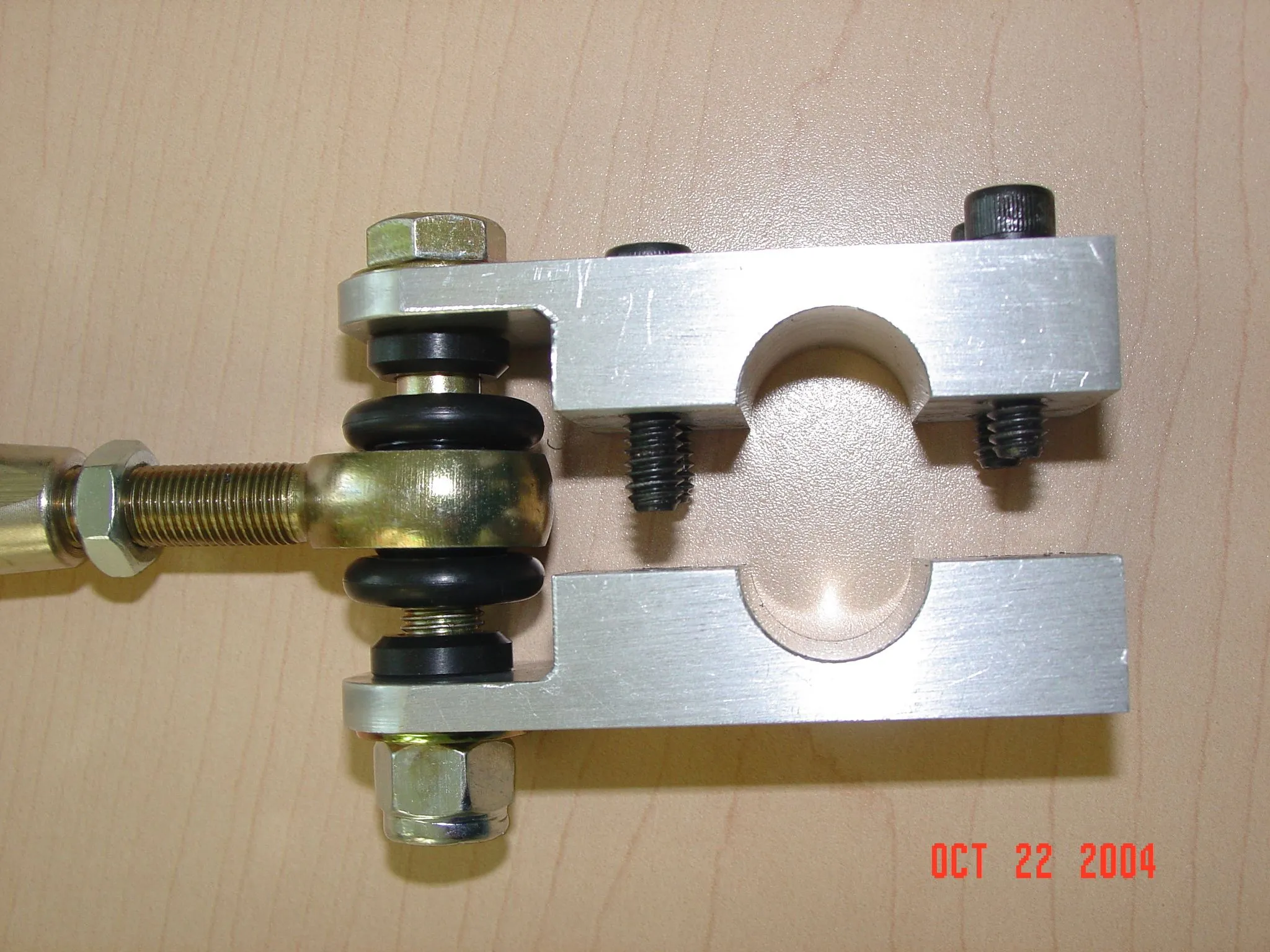

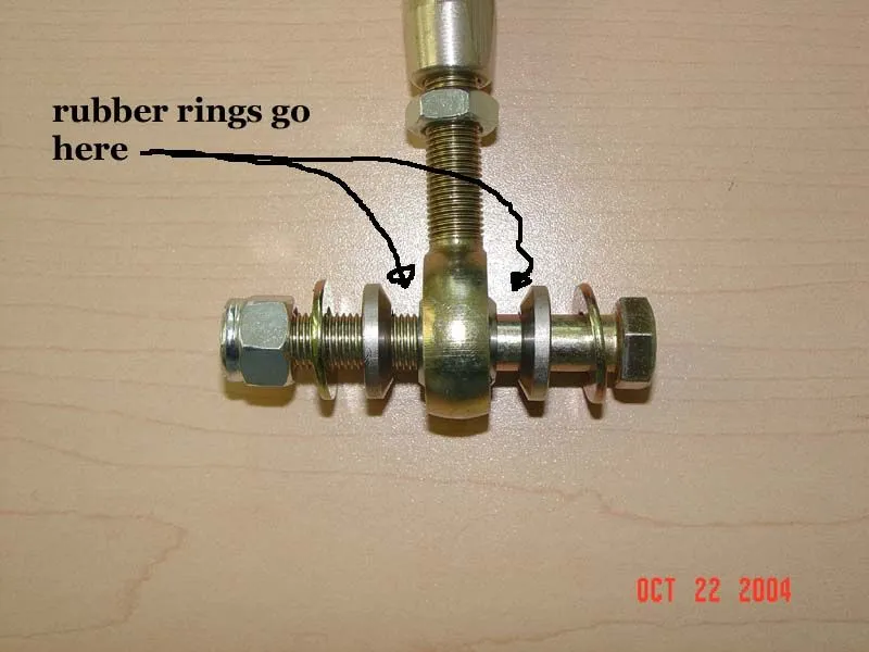

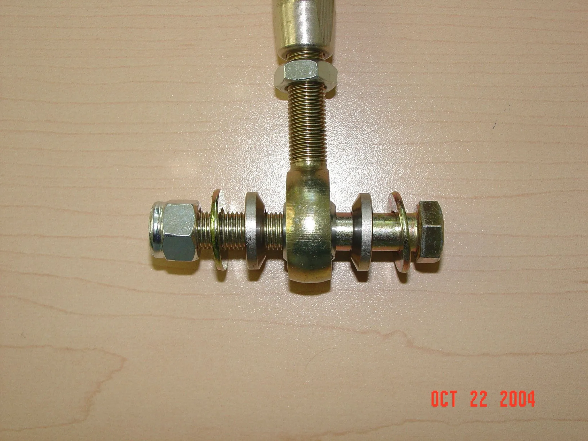

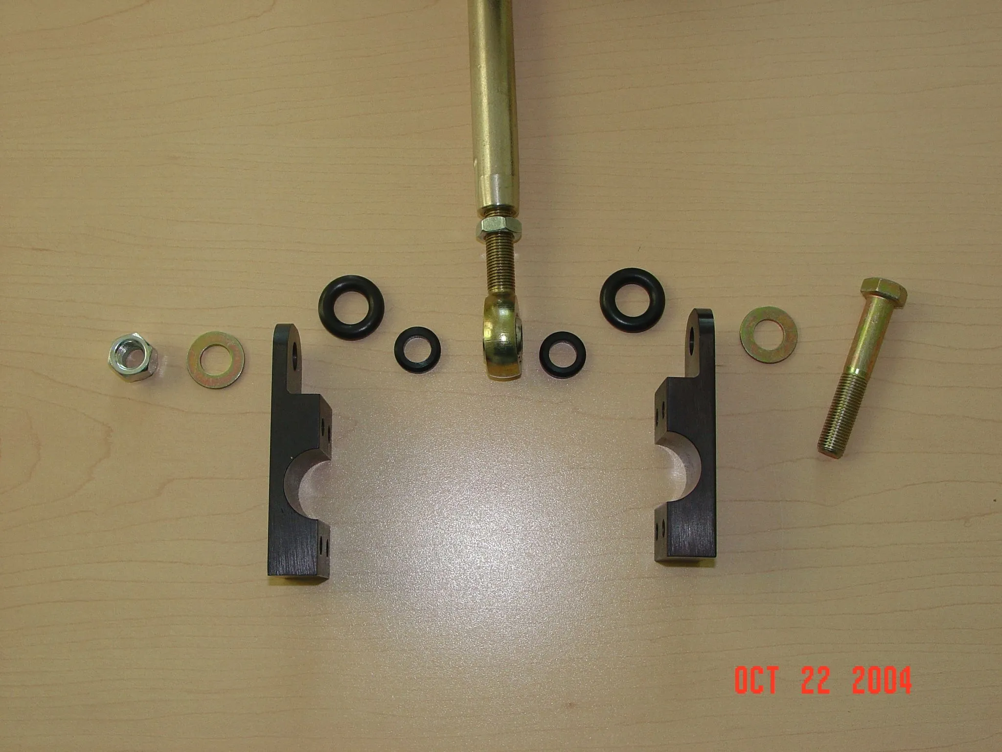

heres some big help for all of you, the large pics awr sent me on how to assemble them
sorry for the massiveness but if you got the money for the bar and dont have broadband, buy that first instead ;)

Awesome post! And Thanks for the pics. The first one is what mine looks like, and I guess that I will make it look like the last one. I don't have that aluminum bracket since these are on a Racing beat bar.
