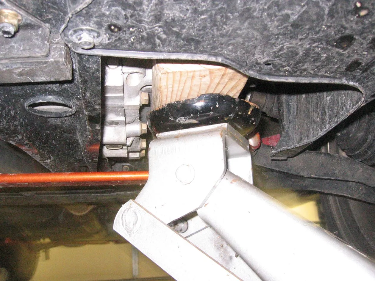

2) Put car on jackstands (at least the front). Support transmission with jack (using block of wood so you don't damage tranny).
3) Find happy medium with jack height, where you are supporting tranny, but not raising it. Jacking it too high will make removal/installtion of mount difficult.
4) Once supported, lock the jack in place so it doesn't lower on accident.

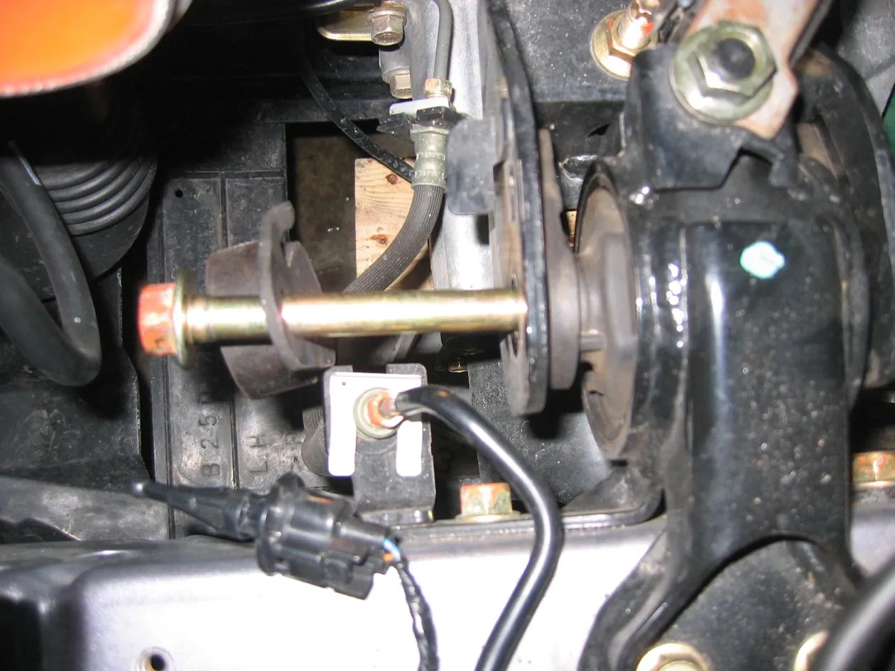

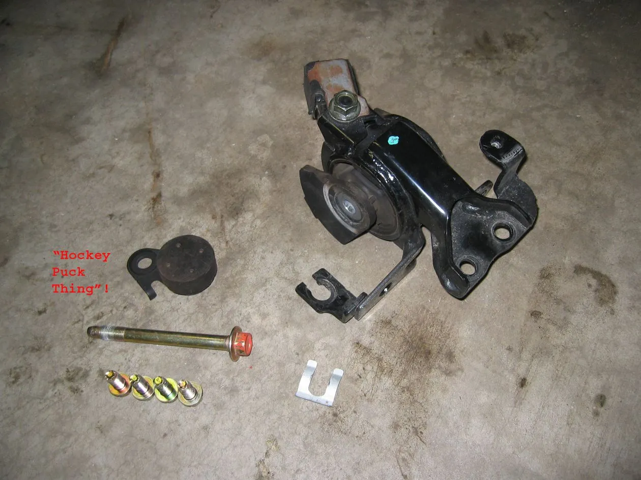

5) Remove Bolt #1. It is a 17mm head. There is a hockey pucked shaped, metal and rubber piece hanging off of the bolt, save this for reinstallation in step #14 if you choose to do so (I did). As with all bolts in this install, you will need some torque on the wrench, but once you break it lose, it just takes time going thru all the threads. I noticed this bolt was hard to remove, since the threads were catching even though they were no longer threaded in. (likely due to jack height). But after a few seconds of pulling and turning the bolt, I got it free.
6) With a pair of standard pliers, remove the clip holding the clutch line in.

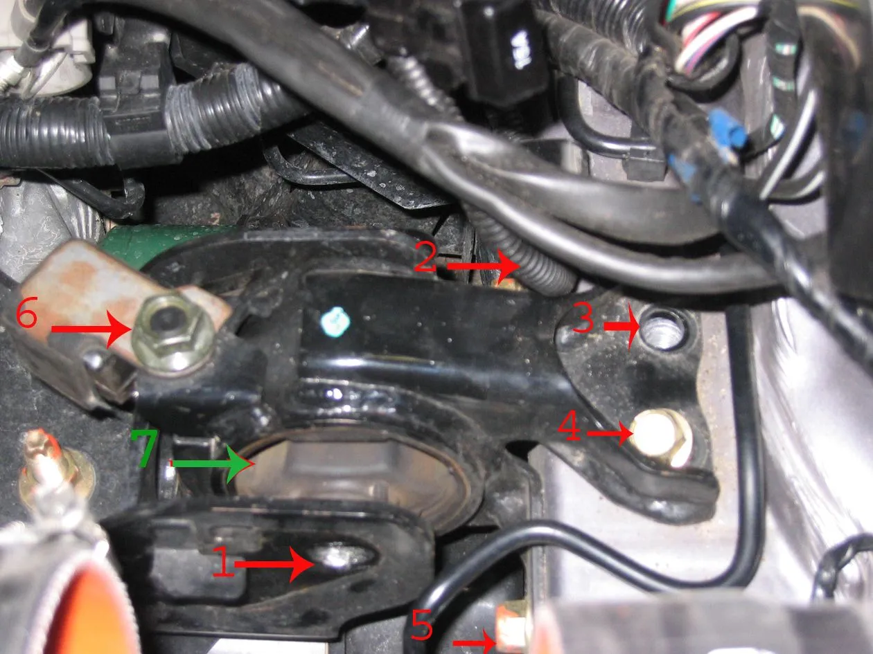

7) Refering to overview.jpg, remove bolts #2, #3, #4, #5. (I believe they are all 14mm) They are gold colored bolts holding the mount to the frame.
8) Being mindful of the clutch line, carefully pull mount straight up out of the car.

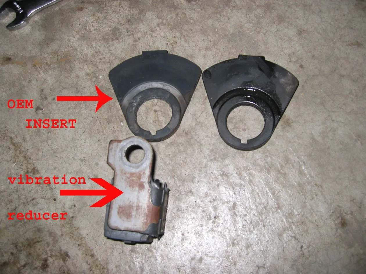

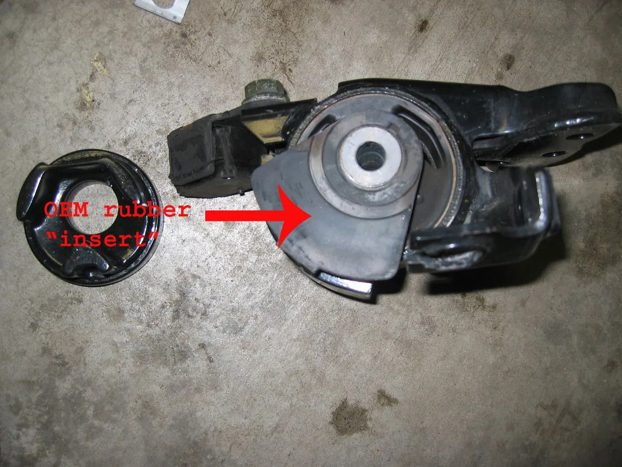

9) Set mount on ground. Remove two "pie shaped" rubber inserts from either side. Save them if you ever want to reinstall, otherwise discard as they will not be re-used.
10) Using a copious amount of WD-40, spray rubber portion of mount and your new poly inserts.
11) Slide inserts into place. The inserts are completely identical, so do not worry about which one goes on which side of the mount. Make sure they are fully seated.

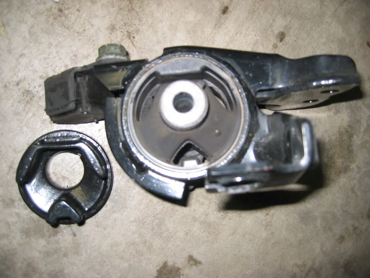

1st set

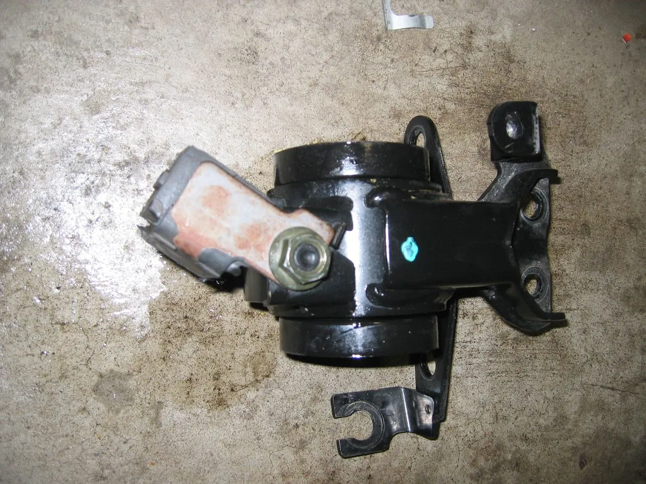

more pics..."Overview.jpg" gives you the bolt number scheme I use in my directions. #7 (the green arrow) in the picture just shows the gap left by the OEM insert. Hope these help!

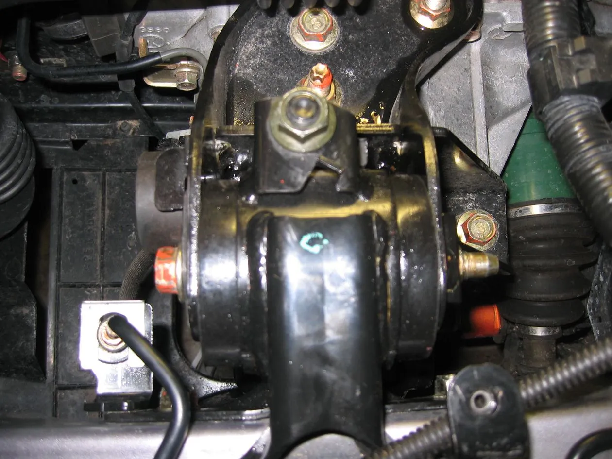

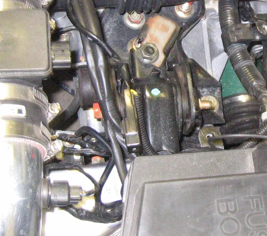

Tony replied. He said to force the insert around the bracket. At first when I attempted this it didn't seem possible. However, I was able to make it work. The urethane stretches more than I thought it would. Success. Both mounts are now mounted, and here are the pics:
mounts
rightmt
rightmt2
trannymt
The tranny mount was a pain to get back on, as I couldn't get the holes to align. I finally realize I could loosen the bracket on the tranny, and that did the trick.
one other thing, you can see in the mounted pics that the right side mount has a couple zip ties to keep the inserts in. They came with white ones, I used my own black ones. Looks better. I ended up using a total of 4 zip ties, two around each side since they weren't long enough.
