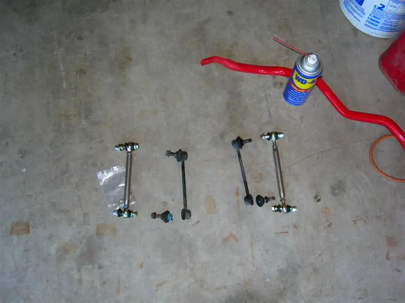

finally installed the bar today. I drive on a windy road near my house here the car feels pleasantly different. the back pivots a lot nicer now and the annoying squeeking is gone (but not the cluncking).
of course thanks for the advice above it made for a relatively easy install

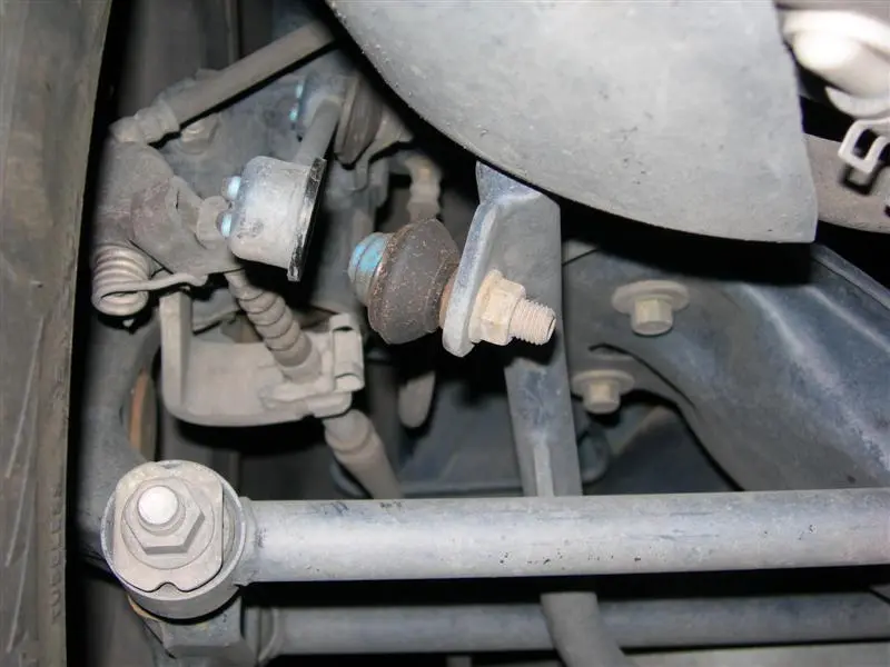

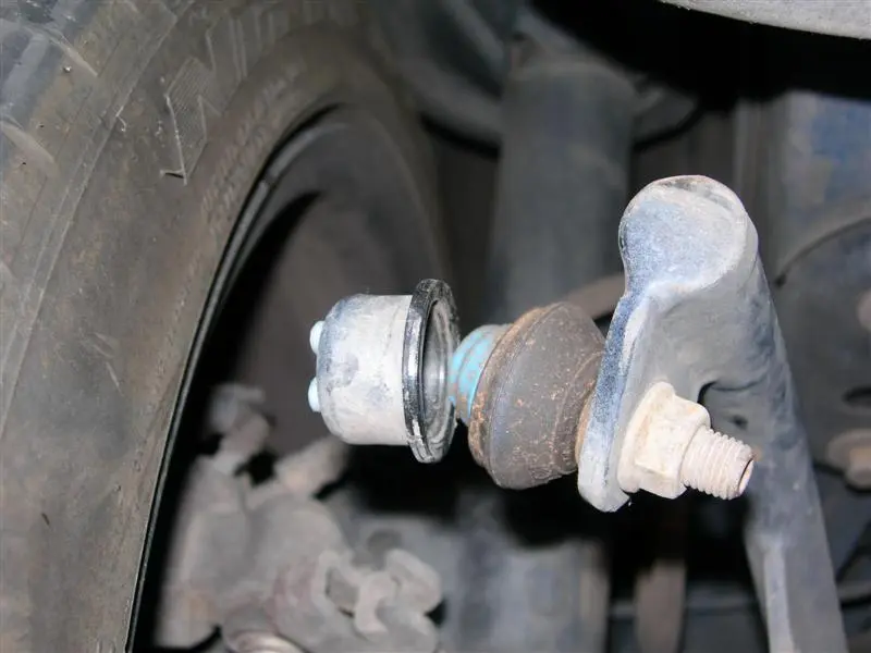

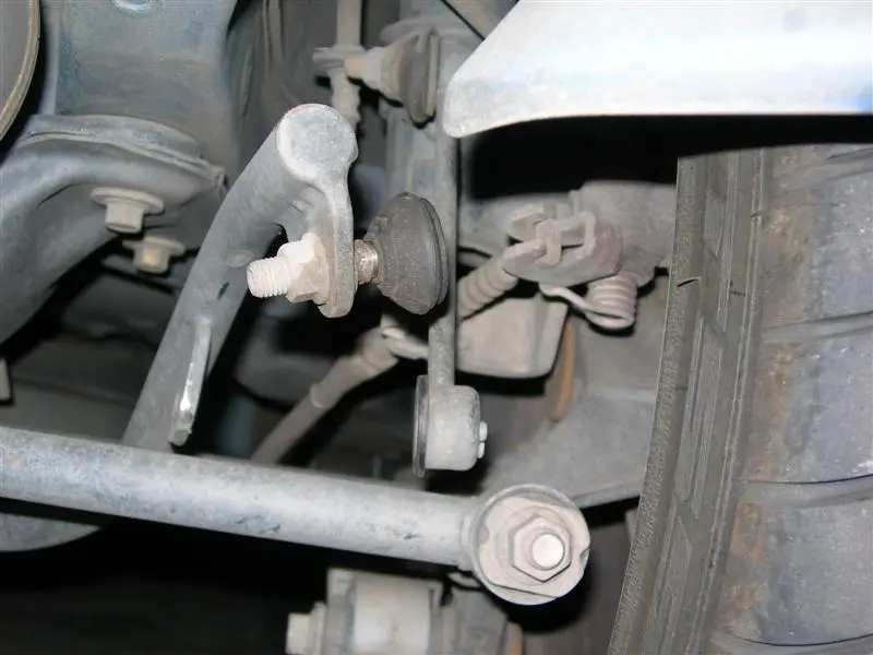

Mine took longer to get the car up on jack stands and the wheels off than it did to get the stock end links off.

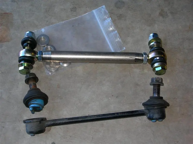

Now I need to figure our how to mount the adjustable endlinks to the stock struts and to the SRMororsports 19mm sway bar.
