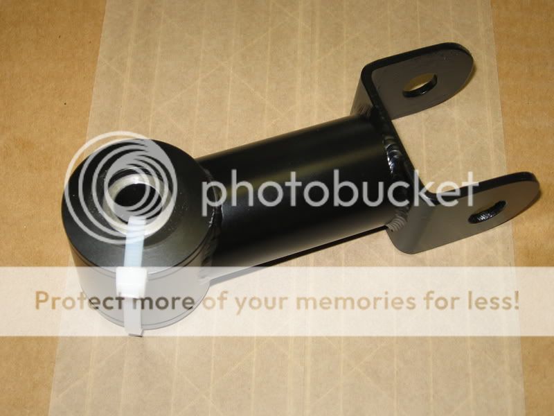

there will be a dogbone style mount that is almost solid that will be available soon. i know this because i am testing it before it goes for sale.
i recomend you wait and buy this from protege garage soon.
here is a pic....
How did you tear the mount apart (boom01) ? What kind of driving are we talking about? The dogbone style mount from protege garage looks great, but with a mount of that style, it's going to transfer a lot of vibration into the car.. mine is a DD and will probably never see track time... just fun. How much vibration transfer did you get from the 70 duro?

i had VERY minor vibration with the 70 and the 88 duro mounts.
i know there will be slightly more with the dogbone but so what......
i will feel better knowing it wont break on me. and the point of using ANY upgraded mount is to limit torque robbing engine movement. eliminating this movement will in no way damage the engine.
my 70 duro mount broke at the dragstrip.... i launched a little too hard got lots of wheel hop and the bushin shredded and flew off the car.
i replaced it with the 88 duro mount, which i had remove to do a test fit for the dogbone mount. at that time i looked at the awr mount and saw that the bushing was all pushed in on one side.
i know of at least 2 other people who have broken these as well.
AWR is a good company with good products, but i think these mounts need to be re-designed.
