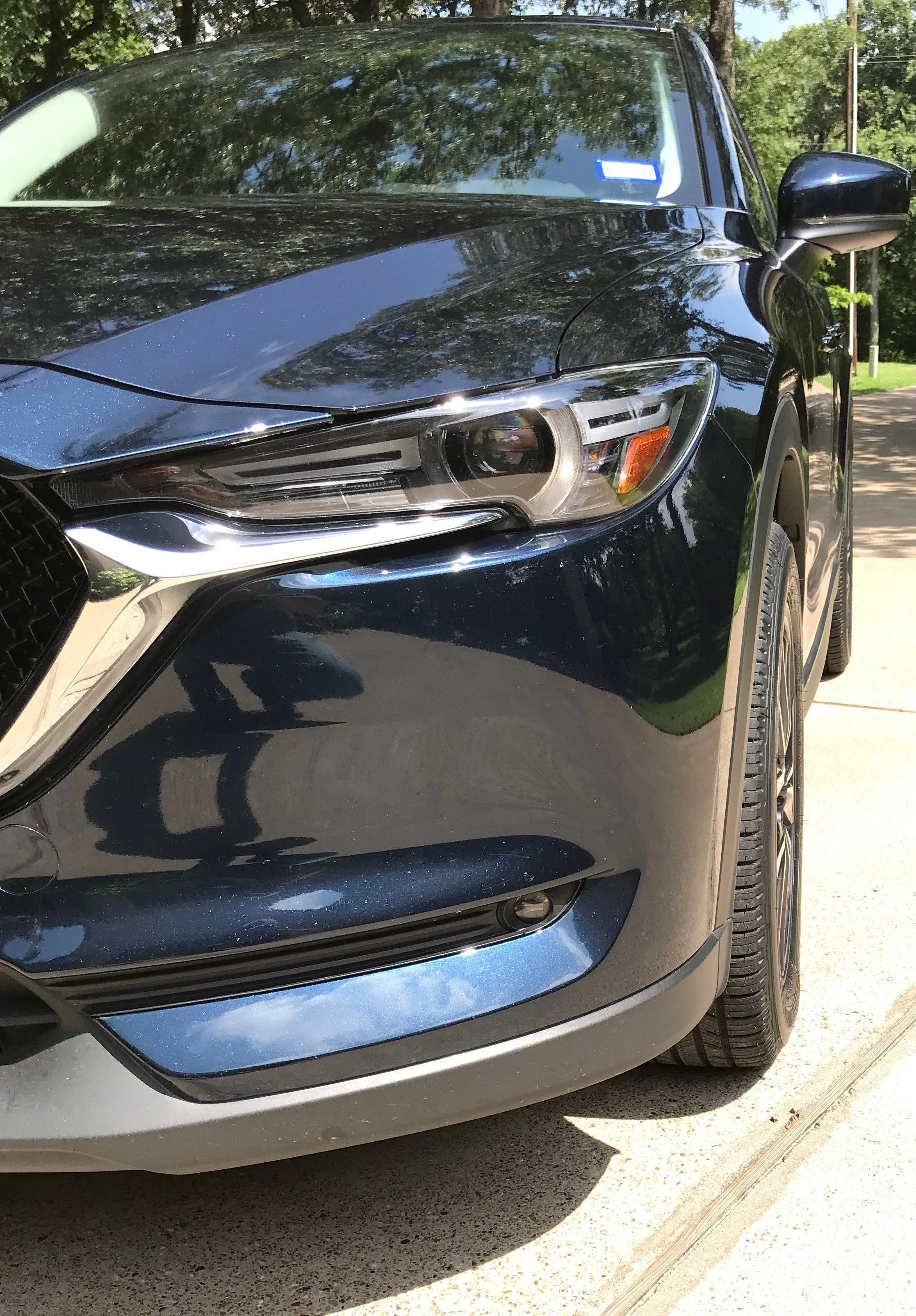

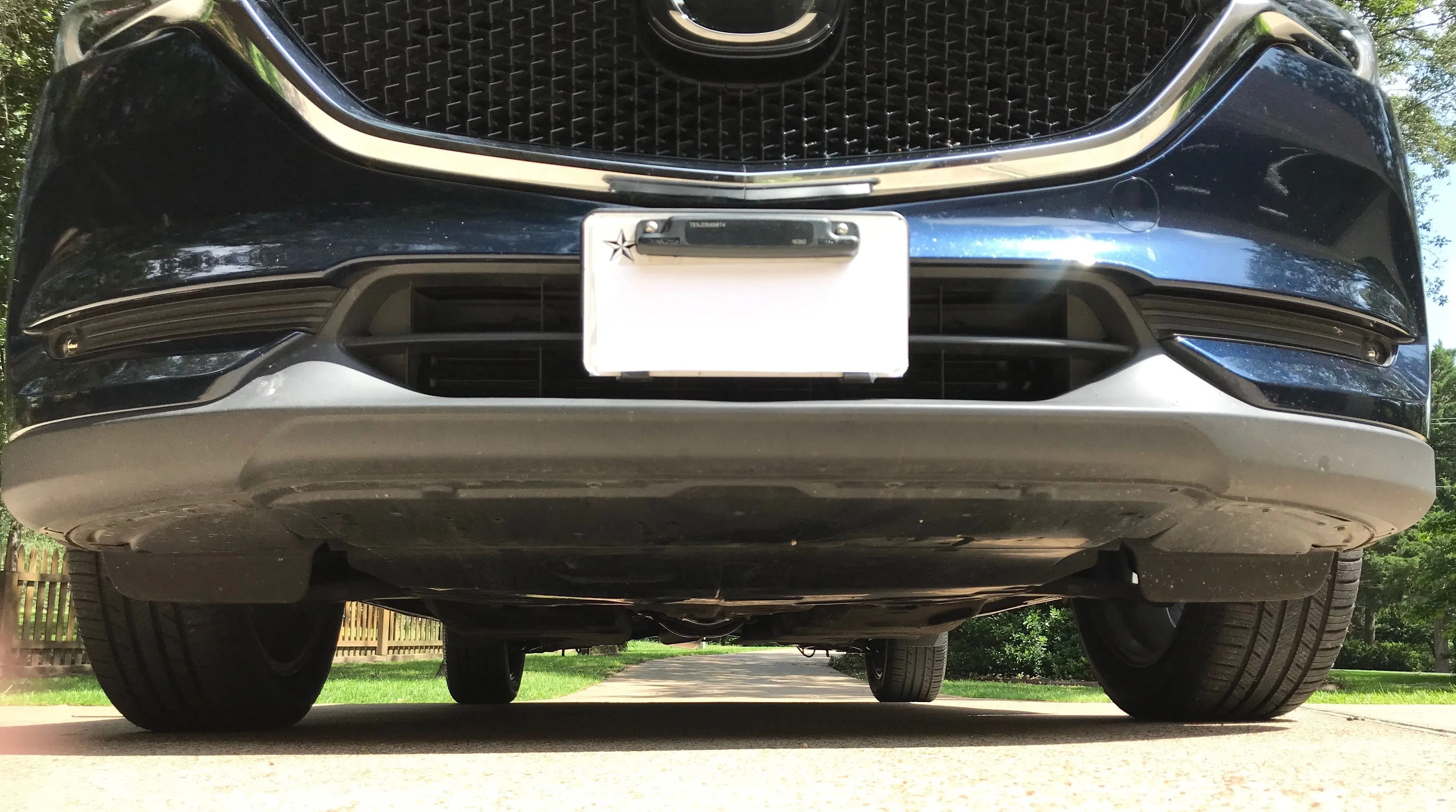

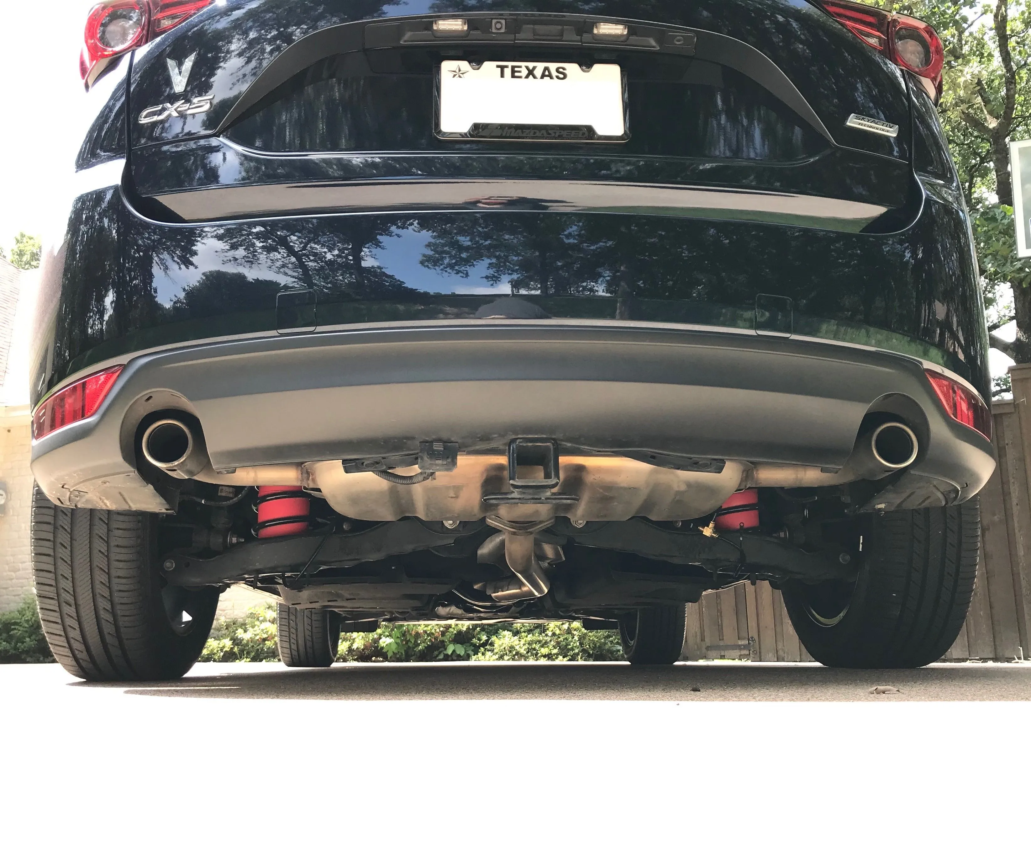

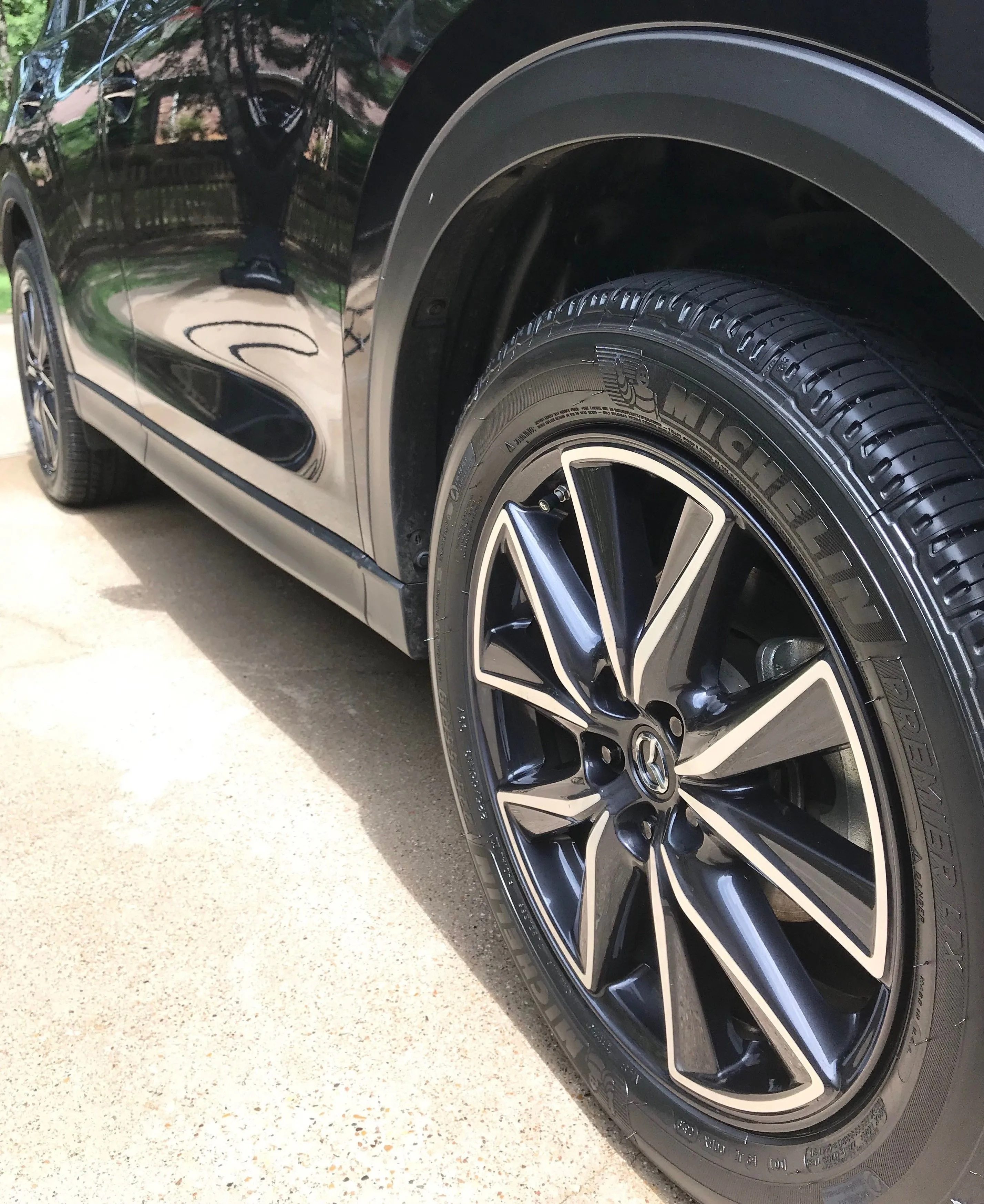

If you go 30 and 25, the outside edge of the stock wheels will be outside the fender a little, but you may like that look. I think 25 on the rear would be fine but I wouldn't go more than 20 on the front. Either way, the stock offset is way too tucked in and you will like the new stance. No problem for AWD or bearings, I had these spacers on my 2014 for over 100K miles and moved them to my 2017.
On the tires, the stock 225 are already pushing the limit on tire width for a 7" rim in my opinion. The tire section width is 9" and the tread width is about 8". If you put a 245 on the stock wheels, it will balloon out a little where the rim meets the tire. But people have done it.
If you want to go 245/50R19 to keep your circumference right, I would say ideally you need at least 8" and preferably 8.5" width wheels, because now the tire section width is probably close to 10" and tread width close to 8.5". Hope that helps.

Hi bigtex, thanks so much for your input, I really appreciate it. You say 20mm for the front, hmmm. Do you have pics from the front and back showing how flush or wide the wheel sits with the fender.
I'll definitely go for spacers now and upgrade to bigger rims and tyres when I am ready.
It's tough to get a good angle to show, but maybe this helps. I think 30 rear and 25 front would also look good, maybe better. It's only 4/10ths and 2/10ths of an inch wider than my setup. At 30mm each of your rear wheel outer edges would be about 1.2 inches further out than stock. I would rather get 19X8.5 wheels and 245 tires, but this helps until then.

Thanks for the pics mate, your car looks stunning I must say. 20mm looks nice when flush, I'll think I'll go 25 front and 30 back.
If I upgrade, then I'll go 245/45/20 et50 (-0.2%) or 245/40/21 et50 like OE and both 8.5" like you suggested.
Thanks again bud for your assistance
