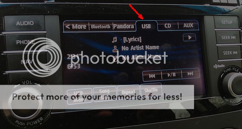

I don't think it's so straightforward as just adding an USB port,
the head unit also must be upgraded also to have USB compatibility and menu tab :
