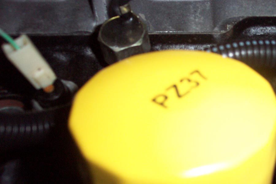

I'm doing that exact same thing, and after researching I hope I've revealed some good info which helps more than just me. That said, I'd like some second opinions to be 100% certain.
I can say with 90% certainty that you can unscrew the stock unit, remote locate both senders using 1 braided stainless steel line with a "T" fitting at the end (stock on one side, AutoMeter on the other), and all while maintaining your turbo line in the stock spot. I've attached a photo for review (bottom-side pointing up) to make sure we are all talking apples and apples. Red arrows indicate what I've come to believe is the stock unit and green arrows indicate where it would unscrew from (I unplugged the small green wire which was leading to it just for the purpose of clarity, otherwise that would still be connected).
If I'm correct, you can use a male to male fitting from that newly freed up spot off the block to go into the braided line. Although I didn't remove the stock piece to check, I did closely compare an 1/8" NPT threaded adapter to it and it looks identical. Therefore, that's what the stock port utilizes. So, with the necessary adapters, I'm fairly certain this can be done with no negative affects.

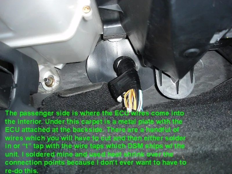

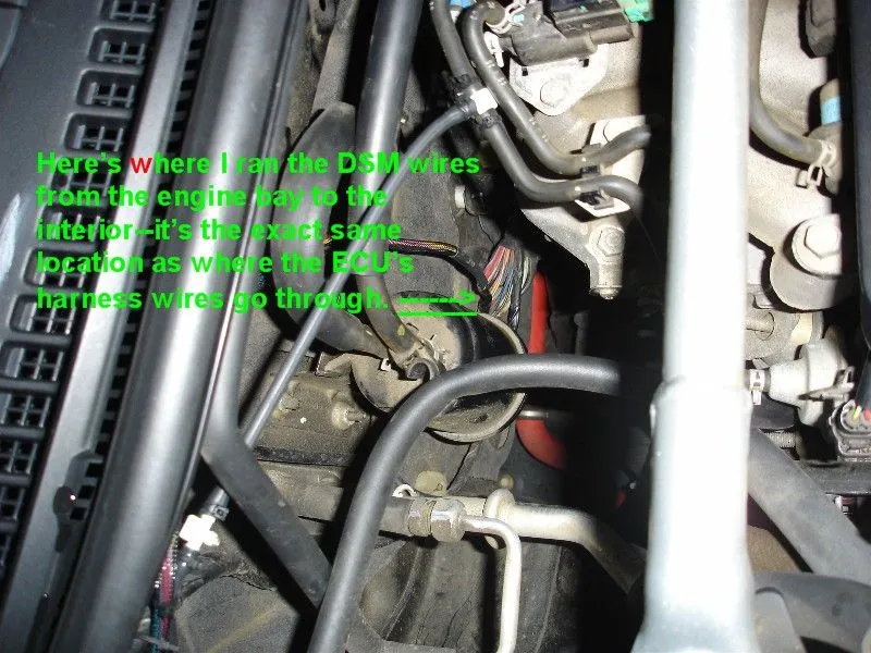

On another note, where are you mounting your tee for the senders? I'm also curious how you are dealing with the AM sender plug that has to be fed through the firewall. They ask for a 1" hole to be drilled but I'm kinda thinking there must be another way (like cutting the wires to feed them through and then splicing them back together again)?

I haven't thought too hard about specifically where I will put the "T" because, frankly, my priority was getting it off the block. Anywhere else I put it will be better than that :) I'll probably make a bracket for it from hardware store parts and bolt it to my firewall.
As for the wire run from the guage to the sender, that's only one small wire. I've attached photos of where I will run it though from the engine bay into the interior (disregard the text in the photos--it doesn't apply here). That's where I will run the wire through using a coat hanger. I'll just electrical tape the wire to the straightened hanger over the end to make it blunt; wouldn't want to catch any other wires off guard while running in through there.
p.s. ignore the vacuum source for my DSM unit; that was wrong and now it's right.

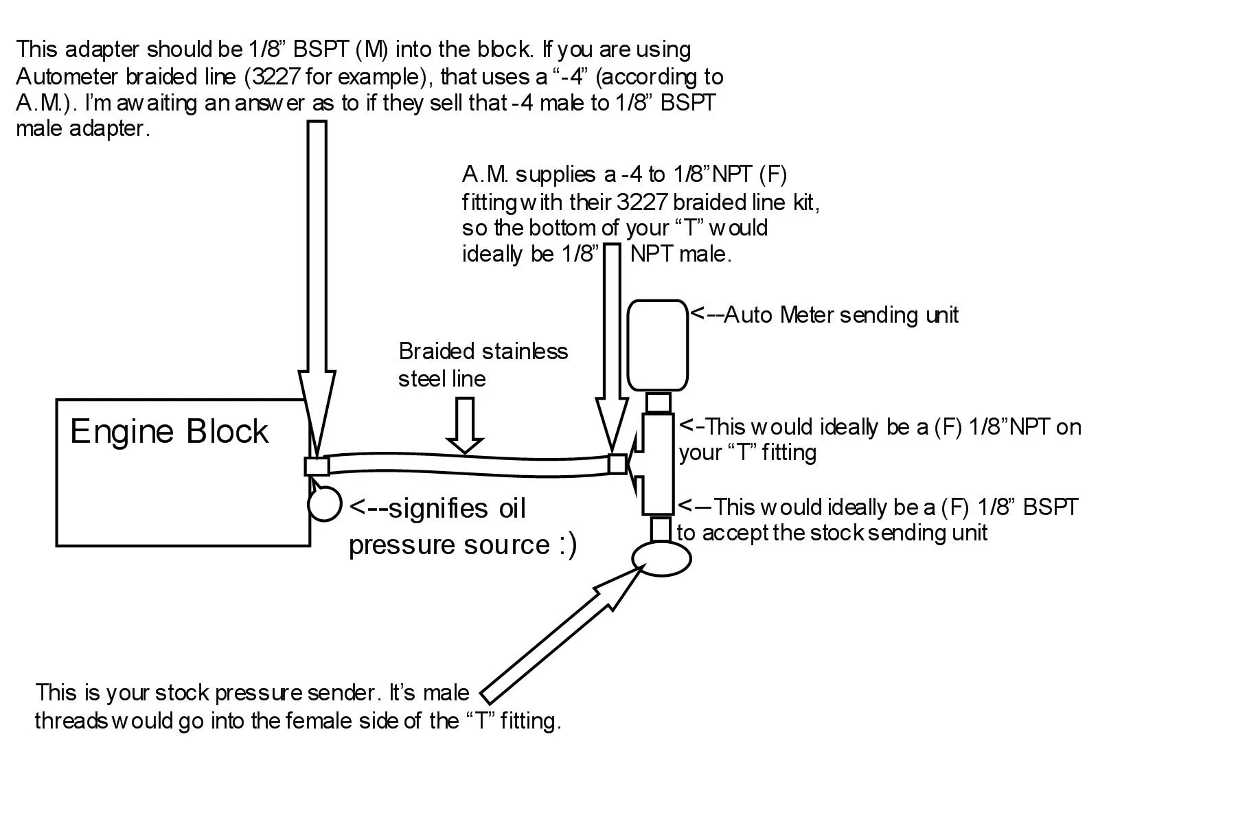

Alright. I got sick of trying to imagine all these adapters and fitting and such, so i did a flow chart for those of you who are wanting to this and make sure you have the right parts before hand.
EDIT: As mspeedP5 said, you need the Auto Meter part # 2269 to go into the block fitting from the AM braided ss line (additionally using the supplied male to male adapter with the AM kit).
As for the "T", it turns out these are very popular in paintballing. They call a male 1/8" NPT bottom, dual female 1/8" NPT top "T" fitting a "male branch tee." If I can't find it through Summit Racing or something like that, I'm going to paintball supply stores. That would just leave the need for an adapter to take the stock sender from BSPT to NPT.
Anyone know where to find that? I keep running against walls in my searching. In the meantime, the attachment should speak for itself.

Now I just want to confirm that the OEM sender is the one just to the above/right of the white plastic connector in this picture...?
Also, is this above or below the oil level in the engine? (ie, do I have to drain oil before removing?)
wicked said:
yes,that is it,and yes you have to drain the oil.
No it isn't the oil never comes over the Aluminium Crank Support plate. You will get some but you do not have to dump the oil...
Make sure you dont remove the one directly over the oil filter. That is the Engine Knock Sensor..
