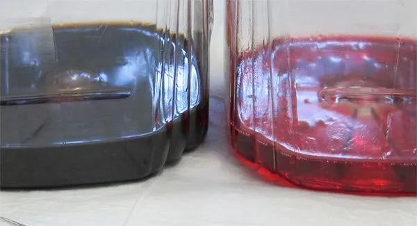

I know this is different atf, different transmission and a different car but here's our Mazda3's transmission fluid after only 10,000 miles compared to new.
And I also realize that appearance isn't the way to judge if it is still good or not. But it is enough to make me order a test kit to send off a sample of the fluid out of my CX5 just to see what they say.
