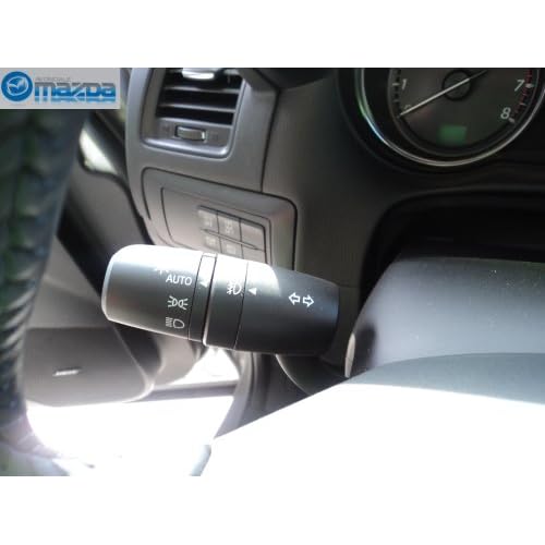

All that does is when you turn on your lights it as well turns on your fog lights. What I'm referring to is the feature where when it gets dark your car automatically turns its lights on and when you turn the car off it turns the lights off too. Majority of cars have this now adays and the Grand Tourong has it but I'm pretty positive this can be done aftermarket.
I have a Touring model with Tech package (and moon roof/Bose) and when the headlight stalk is left on "Auto" the headlights come on at dark (lower wattage daylight running light on otherwise) and all lights turn off with the ignition (with a delay if so set in the menu).
He is showing you the left arrow, you are talking about the right arrow on the stalk...

Okay so I have a CX-5 Touring AWD with Bose Package and I checked my car today and mine does not say auto on the stalk. 100% positive

You will have to change the stalk switch (to get the auto feature) and you will also have to install a sensor on the windshield. I have been told that sensor is the the same one that gives you automatic Wipers when it rains. What I don't know is what else is needed and I also don't know if the wiring harness to hook to the sensor is in the headliner. I have been looking for a wiring diagram but have yet to find one.
You can see the sensor to the right of the rear view window mirror attachment point on the windshield on the tech cars.

It's really not that difficult to do. I did it in my 2011 Honda Accord and my 2013 Mustang. Literally all you have to do is change out the headlight stalk to one that has the "auto" feature. My 2015 CX-5 already has the sensor that is needed. It's in the middle of the dash nearest the window. I have a Touring model, no extras.

I'd agree with ta240 as the Auto-Light Control on Mazda CX-5 GT uses the rain-sensor for Auto-Wiper Control as the light sensor. This means you need a light sensor to add Auto-Headlight feature on CX-5 Sport and Touring, and that's why both Auto-Light and Auto-Wiper Controls always come together in a package for CX-5!
